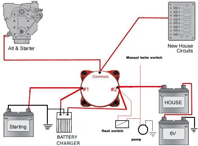

If concerned with field protection, you'll want an MBSS (main battery selector switch) that has the field terminals at the rear.
IMO, this is not a deal breaker if you make certain that NO ONE ever passes through OFF (while the engine is running) when making a change to the selected battery bank.
Most all of these are "make-before-break", so switching between banks (while the engine is running) is not an issue.
As for a two battery set up and MBSS, here is a scenario that is simple yet gets the job done.
(see image below)
Note that only POS and NEG Battery Cables connect to the batteries.
This avoids the Rat's Nest at our batteries.
Each battery bank should have it's own independant Negative connection to the engine.
The O/B Charger leads can use the rear MBSS terminals #1 and #2 for any direct connections.
For any interruptible power, the "common" terminal can power an accessory panel.
All of these circuits should be fused.
Typically, although no rule, #1 will be a dedicated cranking battery, and #2 will be Deep Cycle batteries.
I see more issues with the Perko MBSS (small contacts/weaker spring) in particular the 90* sweep switch.
I'd rather see the Bluesea, Cole Hersee or Guest used.
However, the Perko will work.

A working MBSS will separate the two battery banks from one another when selecting #1 or #2.
Only while selecting ALL/BOTH will the two banks be combined.
Something is either wrong with the way that they are cabled, or with the MBSS itself.
IMO, the DUAL MULTI BATTERY SMART ISOLATOR 12V 140AMP KIT is rather small for your potential loads.
The Bluesea ACR or a VSR would be a better choice.... but again, IMO.
Bluesea also offers the auto-combining unit that would meet your No Manual Switch criteria.
Quite honestly, managing your battery banks manually becomes second nature after you get used to it.

Well, I think that the four open fork type terminals were a give-a-way for me, that the unit may be on the light duty side.
You'll want to cover yourself for the worst case scenario....., such as an emergency cranking load.
140 amps is not very much in terms of starter motor load....... so IMO, it just isn't quite large enough.
The Blue Sea 9112 can handle 450Amps, with a short term cranking capacity of up to 800Amps.
This would be more than enough capacity.
