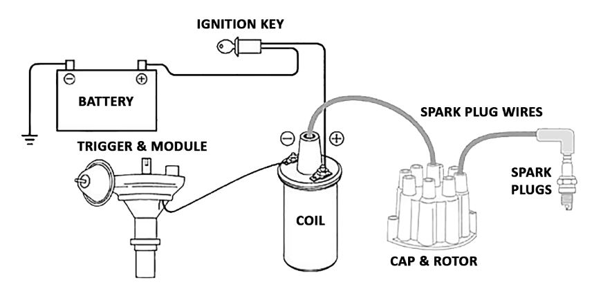

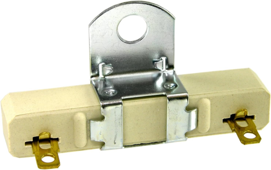

This is what a basic ignition circuit looks like for a distributor with points. There needs to be a voltage reducer in the line to the + side of the coil. Otherwise the coil will burn out.
You can bypass the key by running a wire from the + side of the battery to voltage reducer to the + side of the coil. This is how older cars were hot wired. You still need the key to operate the starter. To shut off the engine you disconnect the wire to the coil.
