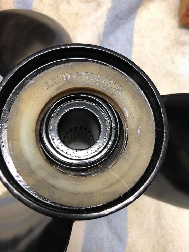

They were powder coated and the plastic "shims" warped and fell out due to the heat. prop plastic insert.jpg

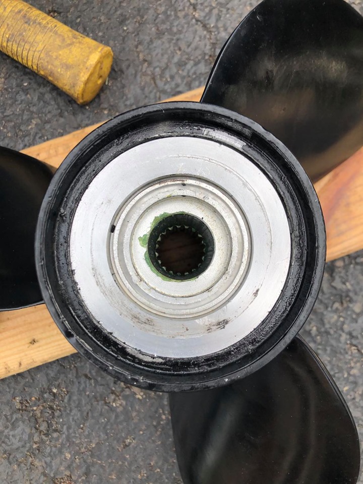

I got my props back and I'm looking for input. It appears to me that there is no vulcanized rubber on either!
This is the larger forward facing prop. It is metallic on both ends of the hub.
This is the other end of forward....

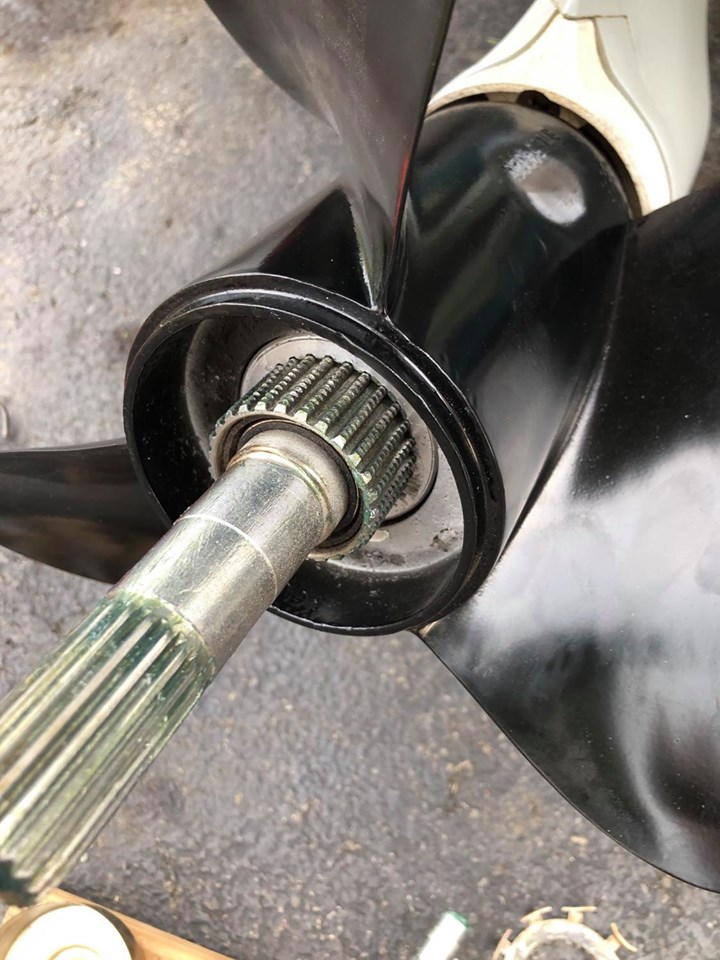

This is the AFT prop. Metallic both ends for hub.
AFT facing cone.
These are a B7 pair.
If you scroll back in this post you will see that the vulcanized rubber came apart from the hub on both props.
Please tell me that this will work~~~ or better yet, the truth! My thought was that the vulcanized rubber was a thrust component of the prop.

So the props had a round solid rubber (?) pice with the name Volvo Penta at the forward end of each. That is now a metallic hub surface. Hope that makes sense. Help!
