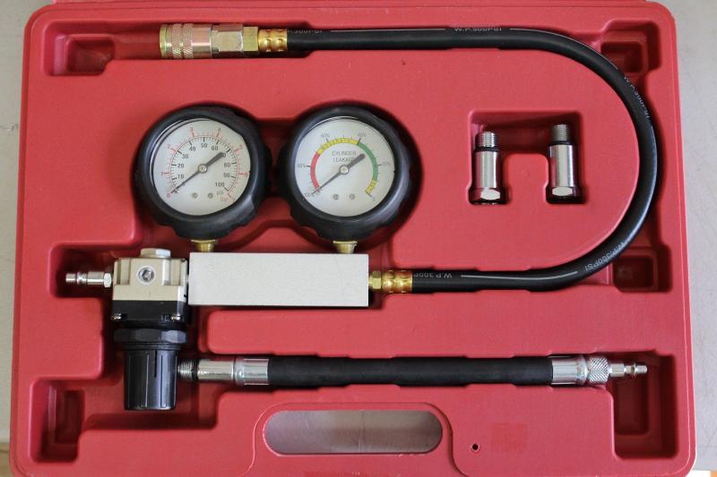

There is no need to loosen the rocker arm nuts.
If you will do a proper cylinder-leak-down-test (with the correct equipment), you will be cycling through each cylinder one at a time, and while at TDC C/S.
You will be doing this starting at #1
cylinder @ TDC C/S and will be going right down the firing order.
While @ TDC C/S, the two valves will be closed.
If you do loosen the rocker arms, you will want to use the 6 stop static adjustment procedure when re-adjusting the hydraulic cam follower plunger depths.
