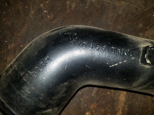

There are 15*-30* aluminum exhaust piecee available. You can have the rubber off the elbow to the angled aluminum and the rubber to final location
I have two in my basement but do not have any part numbers to share. I will look but if none I will not post, if they have part numbers I will post them.
Also look here
There are several different parts, The aluminum angle piece and several rubber hoses
Other than these show and suggested Not sure what else to choose from BUT the cost is a lot less for all of the above
