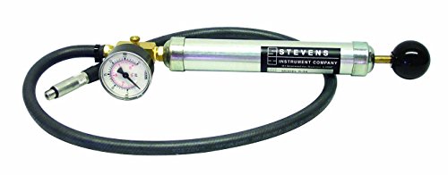

Look up on google, STEVENS GEAR CASE PRESSURE CHECKER, to see what is used for this. I have both pressure and vacuum checkers.

Here is what it looks like.
Maybe you can make your own if you have the materials and ability. You can used compressed air but you need to adjust/set PSI to ONLY 15 psi. Have a on/off valve inline to keep any air from leaking back.
