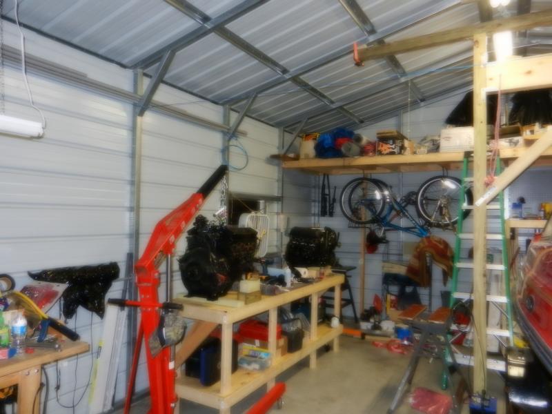

Thanks for the additional comments. In the end I bought a new GM vortec head long block & 4 BBL intake manifold. Progress is pretty slow since I've been tied up with other things & goal is to have this thing running by Memorial Day. Current status is I pulled the old motor and they are both sitting on a bench to swap over parts. Attached are a few pics.

Nice shop. Take a close look at the coupler splines. If the spline edges are rounded you might consider changing it now since the engine is out.
Thanks, Guy. My shop is a work in progress at our Cave Run Lake weekend house - too bad it is a 2 hour drive to get there.

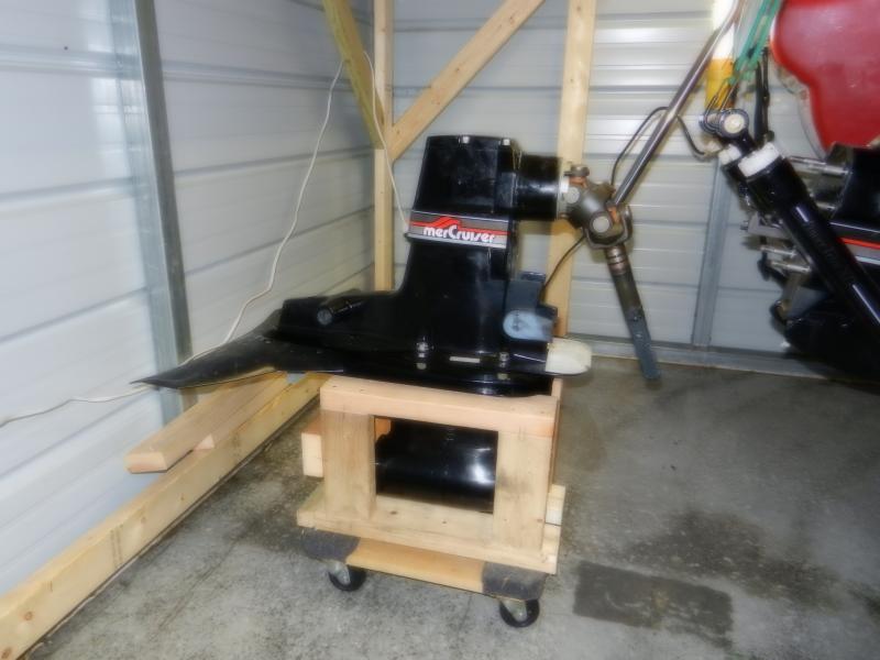

I take it you mean the edges along the length of the splines? Both male and female splines? The male ones looked good but I'll look closer. I'll also change out the water pump / impeller while the outdrive is off. I made a cradle on a Harbor Freight dolly to remove / store the outdrive.

Cool dolly.

That's a Stingray Hydrofoil I put on shortly after getting the boat on the advise of a friend to help get on a plane sooner pulling a skier up and to be able to plane at lower cruising speeds. The outdrive is lined up to the transom studs with the dolly I made, so it doesn't get in my way installing the outdrive but I'll be taking it off anyway when I break the lower unit apart to change the impeller.
