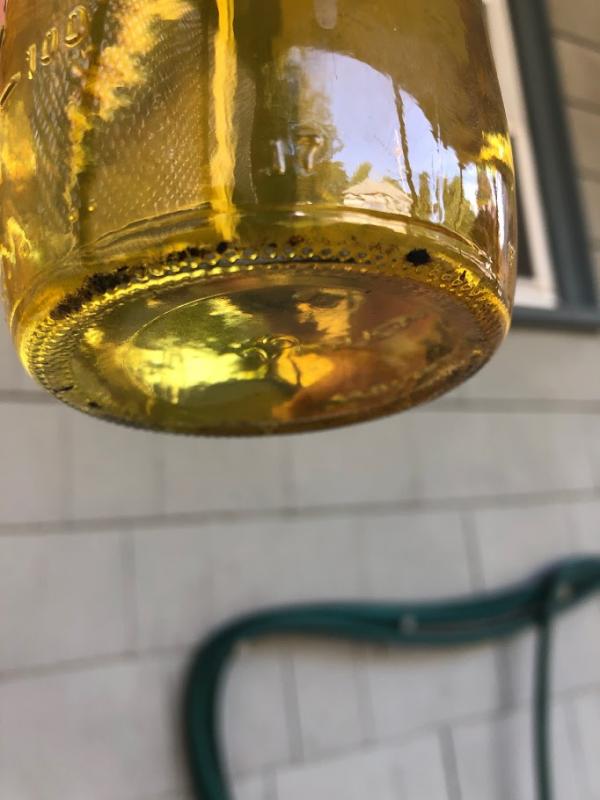

Dump the contents of the fuel filter into a wide mouth glass jar and let it sit for a half hour or so.
Gas should be clear but colored.
IF there is a demarcation line and the contents have separated into two layers, the bottom layer is water.
If the gas (top) layer is cloudy, the quality of the gas is compromise.

Here are a few pictures of the fuel after letting it sit for a few hours. There is not visible separation, but i did notice some debris at the bottom of the container.
Any reason fuel issue like this would not cause issues until 45 minutes of cruising?
I doubt that this is fuel related.
