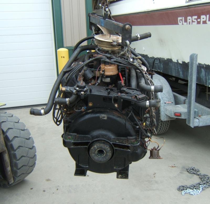

OK, so motor came out on Saturday, all went well thanks for the help..............!
My research tells me this is a 1981 motor, we drained 4 gallons of liquid out of the motor, mostly anti-freeze with some brown sludge that use to be lubricant. Not sure how long it sat this way, but I doubt its worth fooling with. To my inderstanding there was some changes in 86-87, one piece seal, external balancing, valve covers.
I would like to use a newer motor but am not sure if the crank flywheel connection will be a issue...................? Is this possible? If so what do I need to make this happen, we are connecting to a Alpha I drive............Thanks..............J
The new GM crate 350/290HP still uses the old 2 pc. rear main seal and crank design, so you still can get a new motor that will "drop in", and it's built to pretty much identical specs as the 1981 Mercruiser 260.
Otherwise, there are pretty simple workarounds to convert a newer motor.
We ended up buying a 1997 motor and gen II setup that has 32 hours on it...............so the old motor is now a candidate for a big anchor..........Thanks, John
