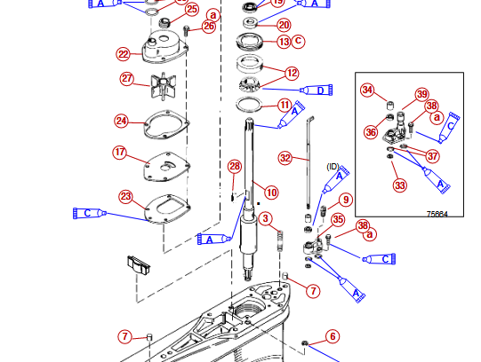

Alpha 1 gen 1 required annual ujoint and gimbal bearing greasing along with the splined shaft.
Alpha 1 gen 2 went to non servicable ujoints and gimbal bearing. Also a grease fitting on coupler to grease shaft which by the way very few ever do, both boat owner or service shop. Many of the coupler grease fittings cannot be reached.
Very bad design.
So many who get a boat dont understand which they have and or are unaware of the differences and what needs to be done.
I pull all outdrives regardless of generation and check everything and grease what needs to be.
