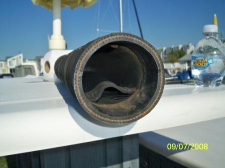

It was one of the 3" diameter hoses that failed. The outside looked fine. The inside layer delaminated and created a baloon pocket that would inflate, fill with water and close off the hose when the engine was running and then deflate when the engine was turned off. The inner layer of the hose is softer and more pliable rubber than the outer covering.
Wow! That's one for the old Keeper File. With your permission, I'm going to post that photo on the Marinette web site.
Jeff
i cant thank u guys enough! it was a piece of the exhaust post engine but pre muffler...which would explain why i didnt see it collapsed when i checked the muffler...got the piece on order 2day and ill be cruising this weekend! thanks a lot!
