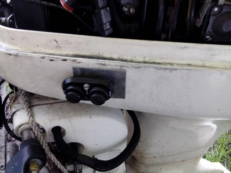

I attemped to install the new trim switch need to remove the orginale first.
there is what appears to be a plastic nut holding the OEM switch on the middle cowling is this a nut to loosen to remove switch?
how is this switch removed?
I was able to unscrew the original switch. (I believe the boat mechanic ruined this switch).
new switch won't fit the original switches location, will fab a bracket & mount sideways. the supplied wire is way to short to locate on transom.
mounted new switch sidways is the best I could do to keep wire hole covered. will test after I reinstall 12V battery.
what should I seal mount plate w/?
Thanks TB

Hey, sorry I never replied. I didn't know there was any activity on this thread, until your most recent post triggered a notification to me!
As for the switch in question; it's fully sealed. 100% marine quality.
I'm not suggesting you scrap the switch you have, but I want to warn you: As the switch wears, you will begin to get shocked, especially if you're in the wet. The switch I left the link to was used to replace the tilt/trim switch that was in use when I got the boat... it was the exact same one you're installing. The guy that sold me the boat warned me about the shock hazard (normally only when bare foot on a wet deck) and have me a cut out piece of rubber to use to push the buttons! LOL. Yeah, I switch it out PDQ. Anyway, the one you have will work for a good while, but if you start imagining you're feeling a little shock when pushing the buttons... it's probably not your imagination. It gets worse over time.
Hey, as to the question of sealing... in that application, I'd probably just put a thick bead of 4200 around it. To make it look half way nice, I'd put lay down a thick bead, then lightly screw/bolt the switch on & wait an hour. Then, when the 4200 is good & skinned over (partially dried) I would tighten some more to flatten the bead a little & make it nice and water tight. That said, it doesn't have to be a good seal. That tiny of a hole isn't going to cause any problems. Not like the engine is sealed, anyway. The cowling just keeps it from getting big waves and wakes from breaking over the engine and swamping the carbs, etc. Water still splashes around through the bottom part, anyway. Any water that happened to splash through your cable hole will just drain back out the bottom.
dam I thought I did something and save a couple bucks o'well. hopefully it will last a few seasons.
I usually always wear rubber soled sneakers but I'll beware of the shock hazard thanks for heads up. I really like the Academy boating section I've returned a few things that I had for well over 6 months very good return policy.

It'll last several seasons. Probably longer than mine, since yours is just the cowl-mounted switch. Mine was the main one, used every time the motor was tilted/trimmed. (It got a lot of use.)
