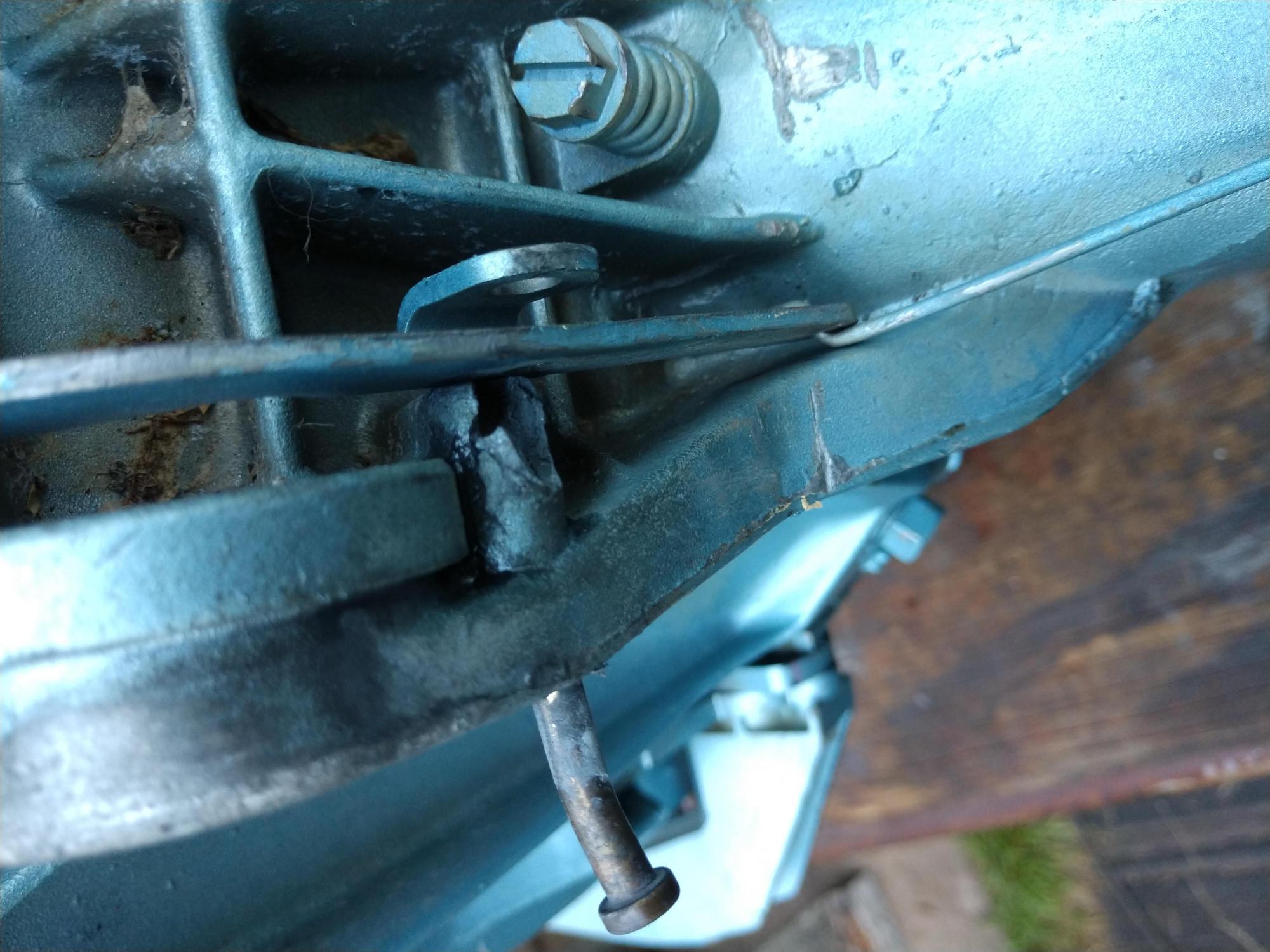

Have a 1990 25 hp Evinrude that when I let go of the steering handle at all the motor will always go to one side. I don't remember which way. Is there a way to tighten up the steering on it, or maybe a part needs to be replaced?

Welcome.....sir.....Looks like this.
Thanks for the quick replies. It does not look to be to difficult, but looks can be deceiving. It is my son's boat and it is at his house, but I use it occasionally.
Should I order the spring also, Part # 72 or does it come with one? The picture of the screw itself is not very clear.

It's probably fine.....try to tighten it. Think you can reach it from the front even while motor is clamped to the transom. There is a grease fitting for that pivot also. That is accessible from the side.

After over a year of my original post, I finally got this problem resolved. Better late then never. It {the screw}was just loose. Goes to show you how much the boat is used!
