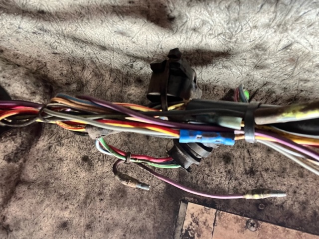

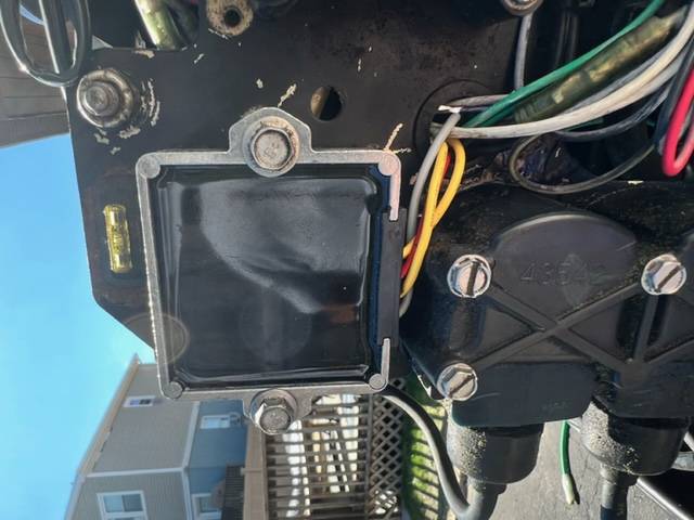

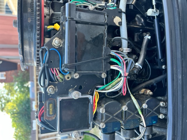

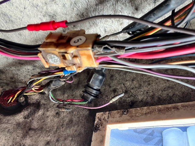

I traced the grey wire from the rectifier to the dash, connected the gauge and it went 0 when I turned key but never moved off zero with engine running. I believe I either have a bad rectifier or a bad gauge. Pretty sure its the rectifier because the gauge was working fine on boat it came from. The guy I boat the boat from said he just replaced the rectifier but he thinks he attached the battery leads backwards one day and possibly saw some smoke coming from the rectifier. I think Im going to start with replacing the rectifier and see where that gets me. As of now theres no signal getting to the Tach or the Tach is bad. Well see I guess...

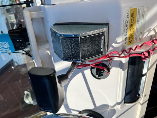

From the pics it's Mercury ignition.
Yup smoke's a pretty good indicator of a problem. :)
Bad tach: usually they don't go bad unless it's fed a lot of voltage.
Try hooking the wires backwards and see if that makes a difference?
