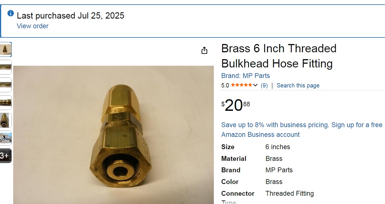

I keep these field fittings onboard
just in case I need to patch that's if I have enough slack to repair. considering carrying extra set of hydrolic tubes onboard also. when I replace current tubes I'll keep the old ones as patch material.thanks Makomark.
