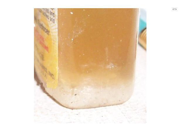

This was year # 3 for my inboard boat with 10 % ethanol gas. The results are in, and they are NOT good.
The negative effects of ethanol gas are apparently cumulative, for I had far more problems this year. And that makes sense, for the White Gook left over (unburnt) from year # 1 adds to the new batch created in year # 2, and now were in year # 3. Several times this year I had to use the Fastjeff Ethanol Recovery Method to get out of my slip. (To wit: With the motor idling best as it can, shut off the fuel delivery system--close a valve, or pull the fuse with electric pumps. Then run the carb dead empty, pumping the gas madly as the motor dies to burn up every drop. Then turn the gas back on. Works great--until the White Gook returns.)
So what's the solution to our ethanol pollution debacle (other than firing all of the government jackasses who stuck us boaters with this crap)? Assuming the problem will get even worse next summer (and it will), then I'll have to run my tanks dead empty and then drain the tanks fully--get every drop of 'liquid' out of them. I can then start all over again, getting a few years out of it until the White Gook builds up again.
Suggestions?
Jeff
PS: For those of you who have never seen the liquid that forms when ethanol and water meet, here's a photo of it (and the bottom of the container). No known additive will make that White Gook burn.

Note: White Gook will go right through water separators and filters, for it is lighter (and thinner) than water.
I drain my separator regularly and have never seen any in the glass jar I collect the drainage in--and it must goes through it since the carbs get it. I also change fuel filters every year to no avail. This stuff is bad news!
