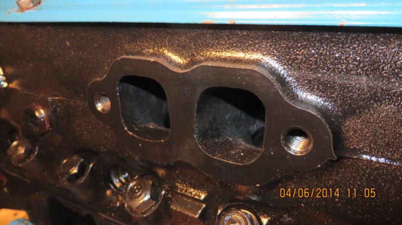

February 4[SUP]th[/SUP]. I purchased a rebuild long block crusader 270 engine with a 7 year warranty from US Engine Inc. / Lake Washington Boat Center, Auburn, Washington. After having several issues with the engine I have it in my boat at dockside. I was in the process of installing my new exhaust manifolds when I noticed for the first time the condition of the exhaust flange on the #4 exhaust port of the head. US Engine says that this is just fine, I don’t think so and am not going to use it. Hence we have a problem between us. I will try to insert a couple of photos, What do you think?
Is this what to expect from a rebuild engine?
The 3 & 5 ports look great. The 4&6 port, with rebuild paint and then cleaned with a flat stone.

I wouldn't like it myself, that's poor craftsmanship! But maybe you should get it welded, & send them the bill! If not, I'd find a high temp bonding filler, and fill it in, then file it flush, and use it. There really isn't much pressure on that surface, nor any water. The exhaust gases are just passing through the open port.
That casting should have never made it past inspection!!!!!!
If they do offer to replace it, make darn sure that you verify the casting numbers.
When/if you remove the head, post photos of the piston deck profile, and post the cylinder head casting number for us.
Let's see if they made any other mistakes!

I have considered the epoxy repair, JB weld rates itself to 550 degrees I would think this flange would run about 700 in normal operation. What other high temp products would be available?

Bummer. Of course the rebuilder is betting that it will seal anyway, and he could be right...or not. Welding would be great except for the expense, the need for machining, and the very real risk of cracking. Personally I would dress the gasket with a high temp sealer (such as made by Deacon) and assemble. You can look the products up on the net and find them at industrial supply houses. These materials are made just for this purpose (sealing high temp metal flanges bolted together) and various sealers are rated for over 1000 degrees. It should work well to fill any gaps and then you can move on and find out what else, if anything, may be wrong with the build. In principle the rebuilder should make the flange right but standing on principle may not get you back in the water.

there is an epoxy out there called marine tech which is very easy to work with and does a good job. I repaired a head on an 135 hp Johnson with this stuff and never had a problem. but that said my first choice would be a refund as this guy's quality control sucks. Good luck.

If you search Google under "US Engine Inc complaints" you will quickly find there is little hope of getting satisfaction from this guy except by court order. You can pile on but he is already well trashed. There is a good chance the manifold/head will seal without a filler, and an excellent chance it will seal and last with a gasket combined with any high temp (non ceramic) filler. Hopefully the rest of the engine will be OK and you can go boating. If it runs, but does not seal (unlikely), then you can replace the head. Not real expensive and you can go after him in small claims court for the cost.
There is a good chance the manifold/head will seal without a filler, and an excellent chance it will seal and last with a gasket combined with any high temp (non ceramic) filler.............
That would be my suggestion at this point in time.
Select a gasket that is perhaps a bit thicker than others.
Install it, run it, keep an eye on it!

I have found a product online that I have seen a couple of negatives about but it looks like it might work for this situation. Pyro-Puddy 2400 high temp sealer and metal repair. Squeezed between two flanges with no where to go it should hold up if it is half what it says.
I think I will try a repair of the head and hope for the best with the rest of the engine.

3 and 4.... Don't waist your time. Use a heavy gasket and run it until you win your small claims case against this engine builder.
