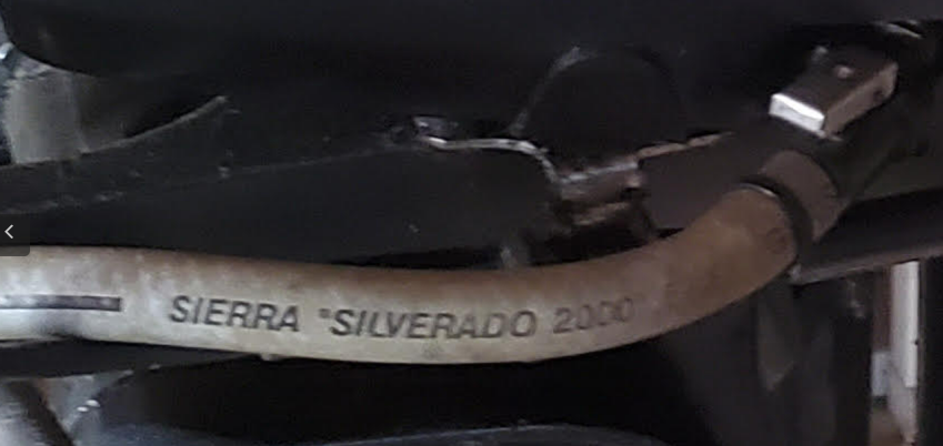

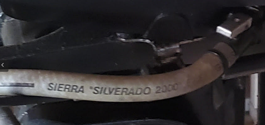

Hi guys. New to the forum and looking for some advice. I put my boat in today to do some trout fishing and the outboard was running strange from the get go. Its a 98 evinrude 20 hp that I've been running for over 20 yrs without a hickup. Seems the fuel is being restricted as at a slow troll it would run for a few minutes as long as I pumped the fuel line buld. If I tried to give it throttle it would stall right out. Heres a couple pictures of the motor and I would appreciate any advice on trouble shooting the problem as the fishing now is the best all year. Thanks. a week and a half ago it was running like a top.

Input a new impeller last fall. I traced the the fuel line to the part on the side of the motor (Crappy picture) and Im guessing that would be the fuel pump? How should I proceed from here to trouble shoot? Thanks

Second, I'm not sure your problem is the pump. The gray fuel line in your picture is a common problem on marine engines. There is a plastic inner liner that was known to delaminate, especially when ethanol based fuels have been used. The hose will look perfect on the outside but when drawing fuel it will suck flat internally and restrict flow. See if you can borrow a different fuel line to test this hypothesis. If you can't borrow one, you can get them at a local store for about $20. You could also go to your local auto parts store and get 5/16" ID fuel injection rated fuel hose and just reuse the fittings you have.
