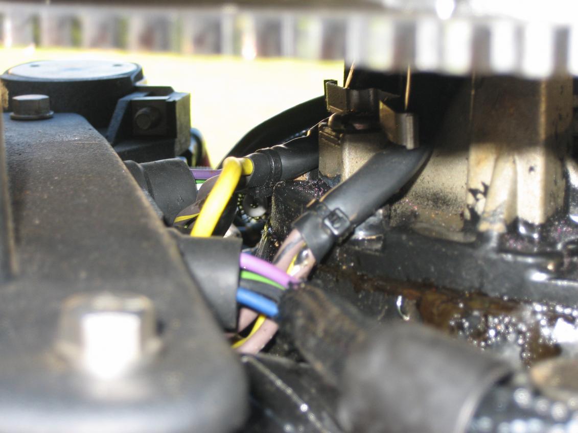

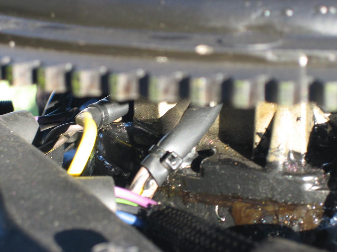

Hey Joereeves,
thank you very much for responding so quickly and thank you for the advice. I took a look at the area that you told me and I am hoping that I am looking at the right wires. These two were at the back of the stator and toward that powerpack, but, not over the power pack. Both the sets of three wires that I think are the ones I am suppose to be looking at had two covers over them, but, one of the sets of wires looked to have some black goo coming out of the bottom of it.
Please take a look at the pictures below, they are tough to see because I was getting so close, but, let me know what you think. If I have to cut off those protective covers, let me know.
Again, thank you so much for your help. If I can get this figured out, I would be so relieved.

That's the general area BUT I'm not speaking about wires.... I'm speaking about the two large Black coils at the rear of that stator. The substance I speak of would be dripping from the black coils if they're melting down.
The pictures unfortunately are taken at a downward angle which prevents me from acually seeing those black coils. Use your own judgement.... if they're leaking, melting down, oozing a substance out of them, replace the stator.
