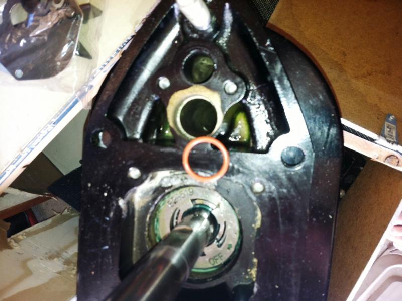

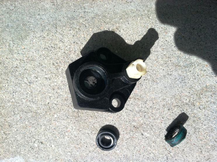

well turns out this kit is great ! went out and found that the 2 spring seals and larger rubber black seal were the rebuild kit for the shaft seal and the orange rubber and the small spring seal were for the shift shaft rebuild so now I'm stoked!
I have rebuilt the water pump and the the other two units out of this set! Now down to the large orange seal which I assume is for the prop housing and one unknown ( brass with rubber) that I will look up with your links!
see pics
