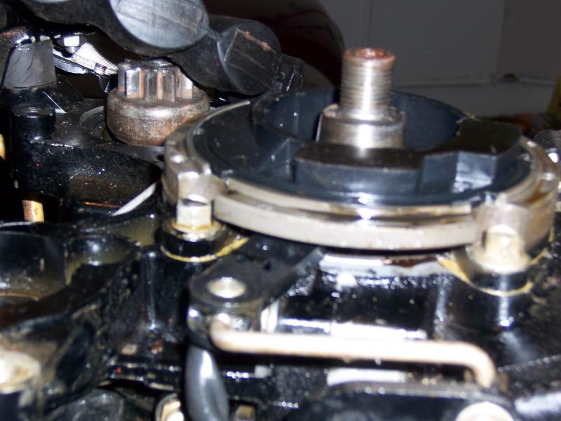

Took it out today with the mechanic. Ran like it should then dropped off a bit the up again then down. Perplexing but he has diagnostic gear left from his old marine business so we pulled the flywheel and then I removed the stator. There were a couple wires that go to the rectifier from the stator that were missing old rotten spots of insulation. I used some high heat tape and rewrapped them . My motor is in the 4707239 serial # for 1977. The pics are of the stator and the trigger and I need to order a service (shop) manual for it. Which is best to get? I will more that likely need to order a stator and /or trigger also but the mechanic said to wait till he gets some equipment together. His shop manuals went away when he sold his business.
Thanks,Mike
Those yellow wires are solely for charging the battery. The ignition system is self-contained and does not need a battery at all.
I suspect your stator is shot. Sorry.
Jeff
Jeff, Should I get a new trigger when I order the new stator. I will probably go with Sierra or Merc Parts . Will I also get some form of decent instructions for installation. Thanks, Mike PS, Is there any chance those two wires could be arcing and causing a power fluctuation?
Ordered a new stator from our host at the forum. Great customer service and a very livable return policy. I'll update with the next test run that may take place in the next 10 days. The turnaround on shipping is excellent.-Fuddyduddy
