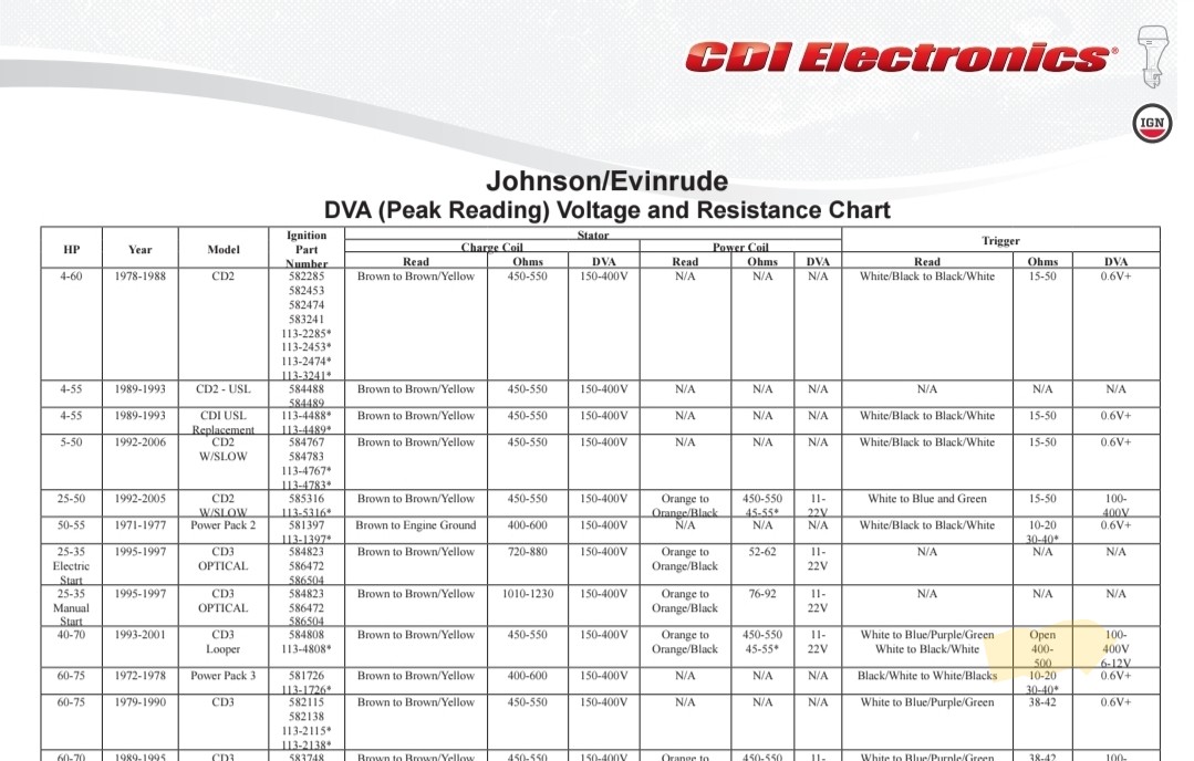

I've found a voltage and resistance chart on CDI electronics website and for my motor trigger ohms is saying open 400 - 500 I'm not sure what that means. All others are showing 15 - 50.
