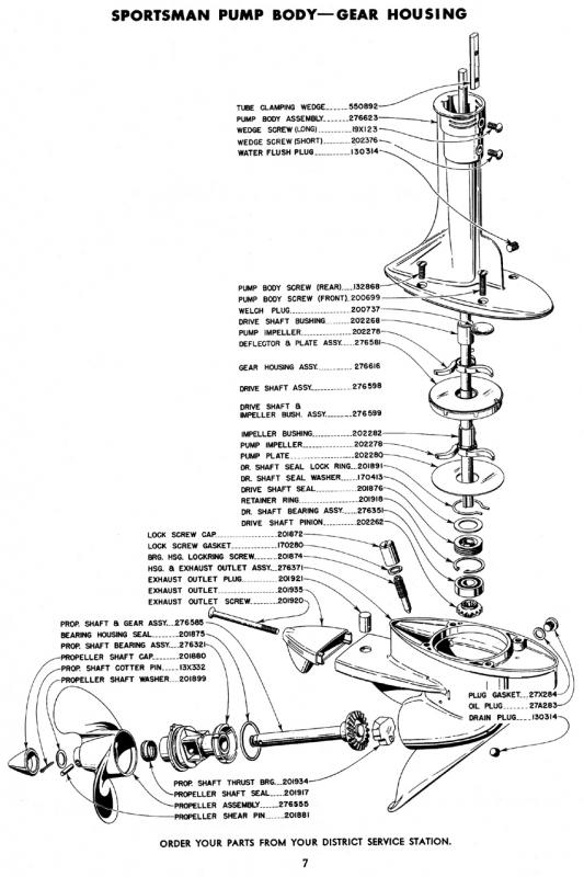

Does anyone know the part number for the little 1.5 waterpump impellers? 1949-1951 4425 sportsman? Cant find much on this motor and would like a parts diagram but cant find it.
Good luck finding them.

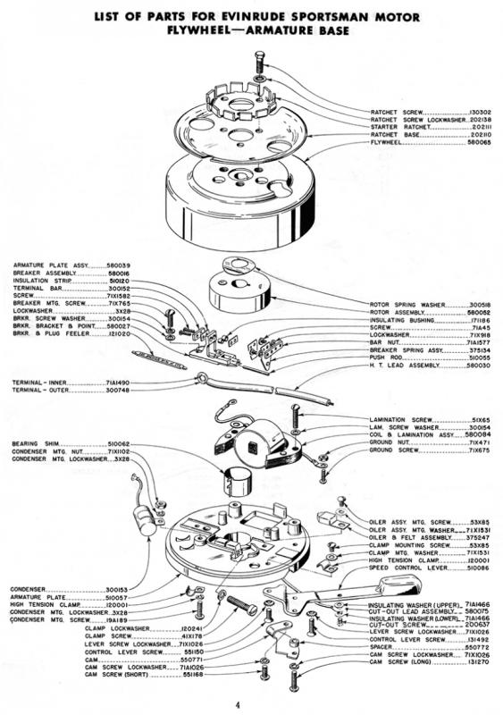

They look just like the ones in the pic and are nice and flexable so maybe they are fine. Was going to change them if I could find new just for piece of mind. The little outboard runs great but will probably not get much if any use. Fdrgator-any chance you have a parts diagram of the top end? I cant even find that! Would be nice to see if coils, condenser, points, ect can be found if needed!
