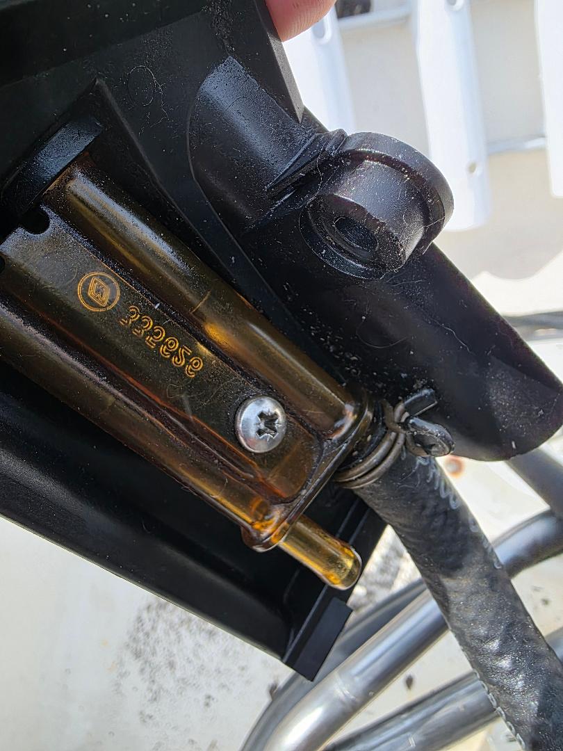

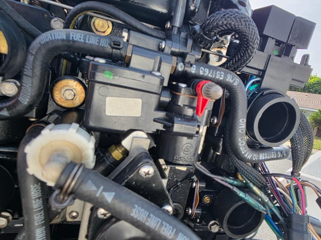

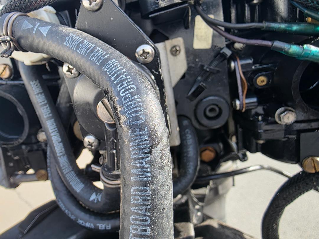

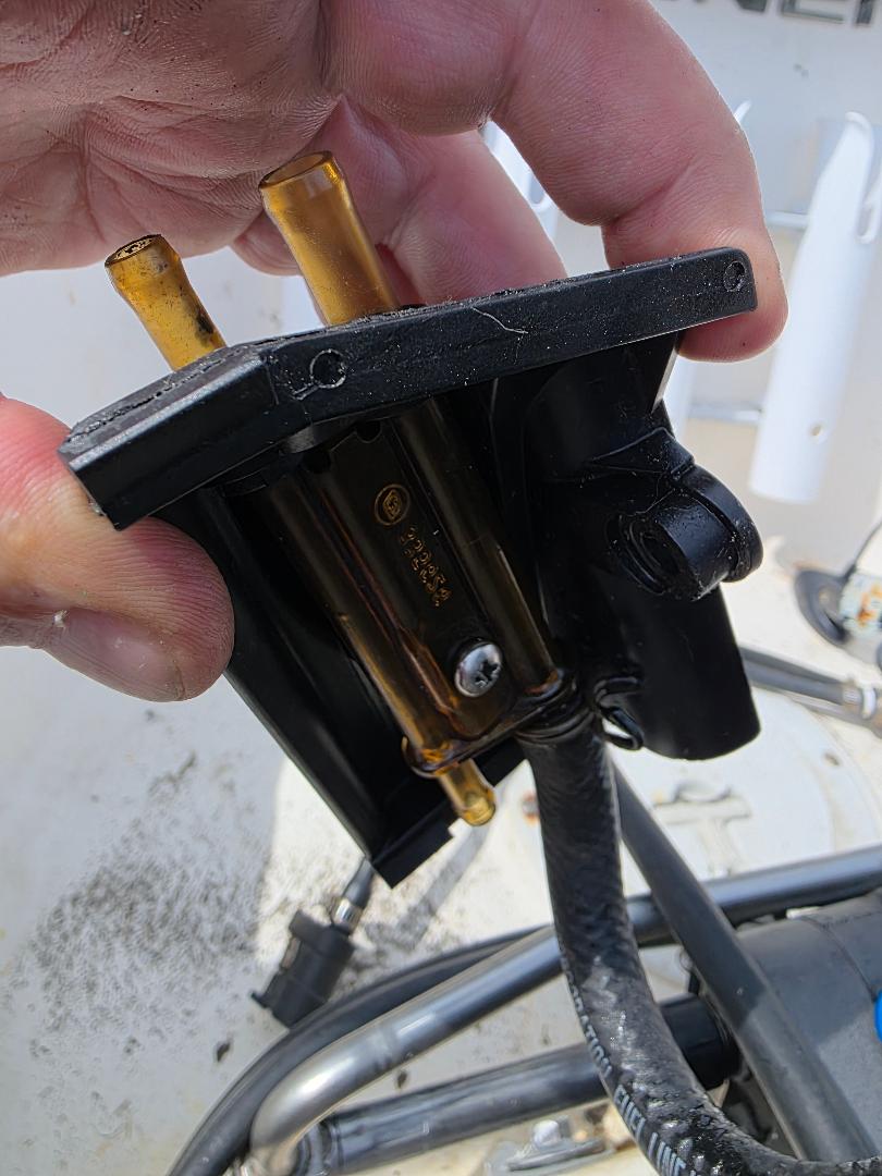

pretty sure this is the VRO? i did not intend to use it. however see the hole on the engine, is that where there should be and adapter for the fuel hose to connect?

Looks to me that someone decided not to use the VRO system, they have a high failure rate. I eliminated it on my motor and now just do premix. So a regular fuel pump may have been installed.

racerone say pic three is the fuel/oil line connector on the engine side. trying to find a connector for the hose that matches?
