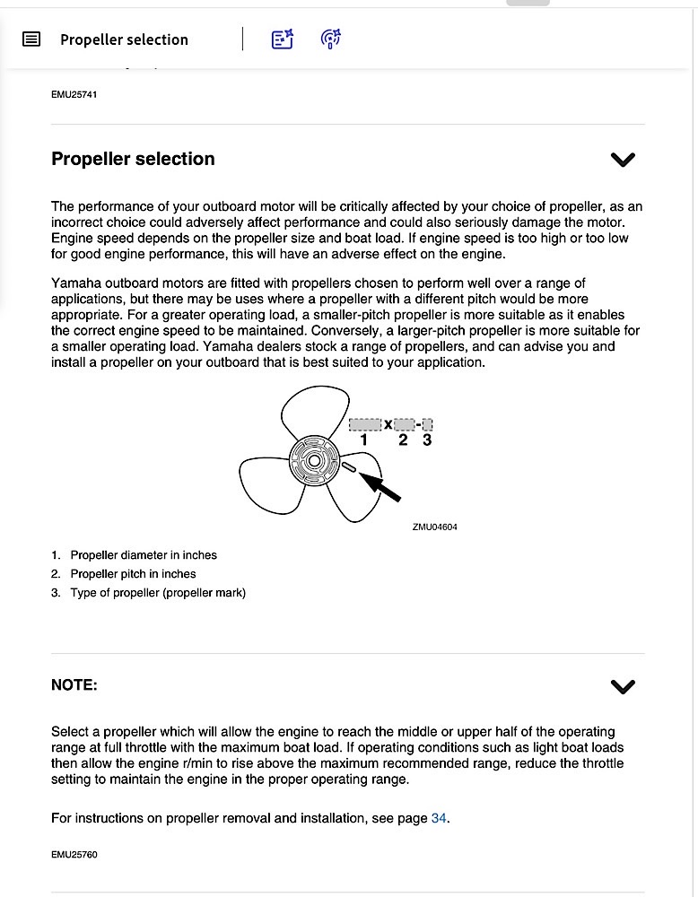

I have a Yammy 8hp manual for a mid ‘80s motor I picked up for a cousins cottage. It says 5000rpm. This page is the only intel I have on the prop nomenclature. Often the prop specs are also on the hub, maybe they re painted over?
It leads me to believe you have a pitch of 5 3/4”,which I believe is the finest you can get.

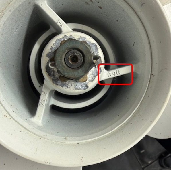

How about 69G?
How about 69G?
I think that’s what he has now. I’ve read some posts that report the prop you’ve hilighted has been misrepresented as other ID numbers.
I believe he has a 5 3/4 pitch, all the props I’ve been able to look up, with that pitch, are around 11” diameter.
Diameters in the first column. Pitch in the second column. Part number in the last column.
The part number highlighted is the current Yamaha part number. There are other Yamaha part numbers for propellers having the same diameter and pitch. There is more to a propeller than just diameter and pitch.

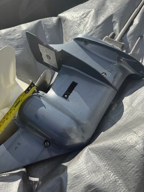

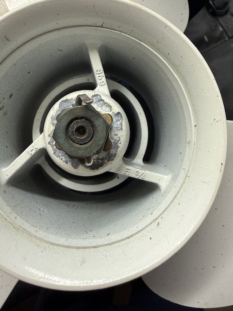

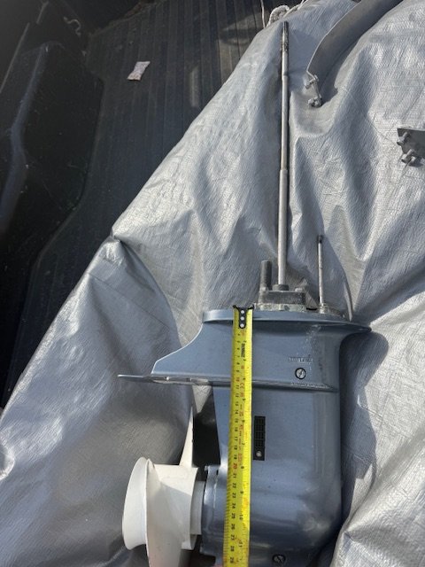

thanks for your comments. here's the prop i have. the boats a 2006 Grady 208. 5600 pounds, on the trailer full fuel no gear.
some comments I'm getting elsewhere are saying a 9.9's not going to make much difference would changing to a different prop do the job?
I owned a 1984 Skipjack 20 with 350 V8 that weighed a little more than your Grady. I was running a Yamaha 9.9 HiThrust and the most speed it would make in calm conditions was about 5.5 knots. I don't think that a prop change would've made much of a difference in performance.
No, it won’t. The prop you have is, as I suspected and posted earlier, the finest pitch prop you can buy for that motor.
That fine pitch with the larger diameter allows your engine to spin up to its full RPM, it’s exactly the same as when I used to fly airplanes with variable pitch propellers. We use the finer pitch for takeoff to allow the engine to spin a full RPM and generate the full power to get us off the ground.
Moving to a 9.9 engine, it’s going to give you roughly 25% more power, but only if you also equip it with the sailboat prop that will allow it to turn its full RPM.
For reference, many years ago, I used to keep a boat up on Great Slave Lake in the northwest territories Canada. I had a little six horse mounted on the transom of a MerCruiser IO. The fact that the motor is mounted off the centre line meant that as soon as the wind picked up the bow of the boat and shoved it around, I would have to go to full throttle and full angled steering, and even then it would take a fairly wide arc to get it back in line of where I was trying to go.
That’s the reason a lot of the fishing boats put a bow mounted motor on. It drags the bow around exactly where you want to go. On a boat with the weight of yours I would think a 15 would be far more effective, but you’re still going to see the wind to grab the bow and swing you around..

69G. As per the Yamaha data.
