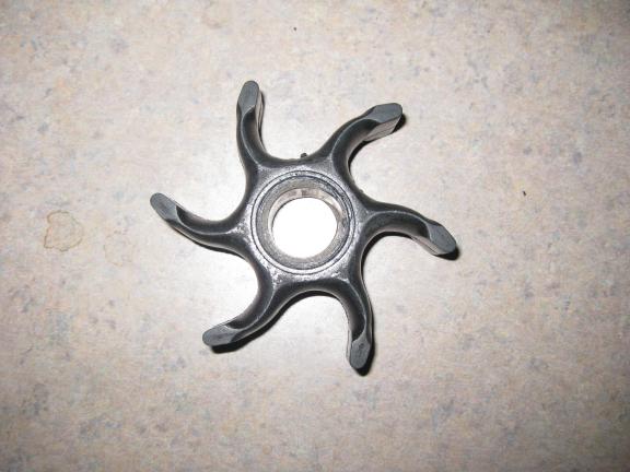

We think this (the attachment) may have had something to do with it. I took it tubing and it ran like a champ. Idle was too low, so my neighbor showed me how to adjust that a bit. All in all, I'm glad it's fixed, and I learned how to check compression and adjust idle.
