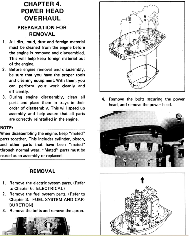

I am ready but cant get the powerhead off. I have followed the manual
but it does not show me how to remove the intermediate cover so I can
get to the bolts to remove the powerhead.
I dont see anything else to remove. Anyone have any drawings etc?

That number makes it a bit older than '88.You have a Yamaha built Mariner. There should be four 10mm bolts inside the pan allowing the pan to separate and show the powerhead bolts.One of them can be seen under the powerhead in pic.The other three are at opposite sides

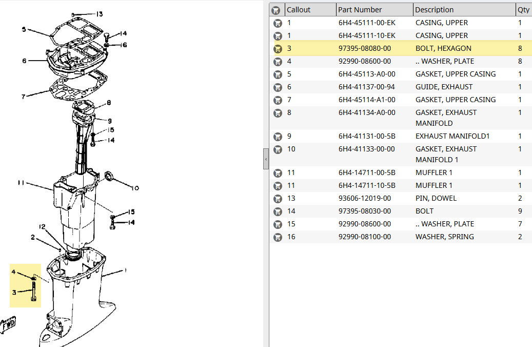

You must remove the 8 bolts that come up through the drive shaft housing, and remove the power head to take the lower cowl off. Once you get the power head off you'll want to get the cowl off to clean up the exhaust plate and replace the gaskets (that's why it comes off).
