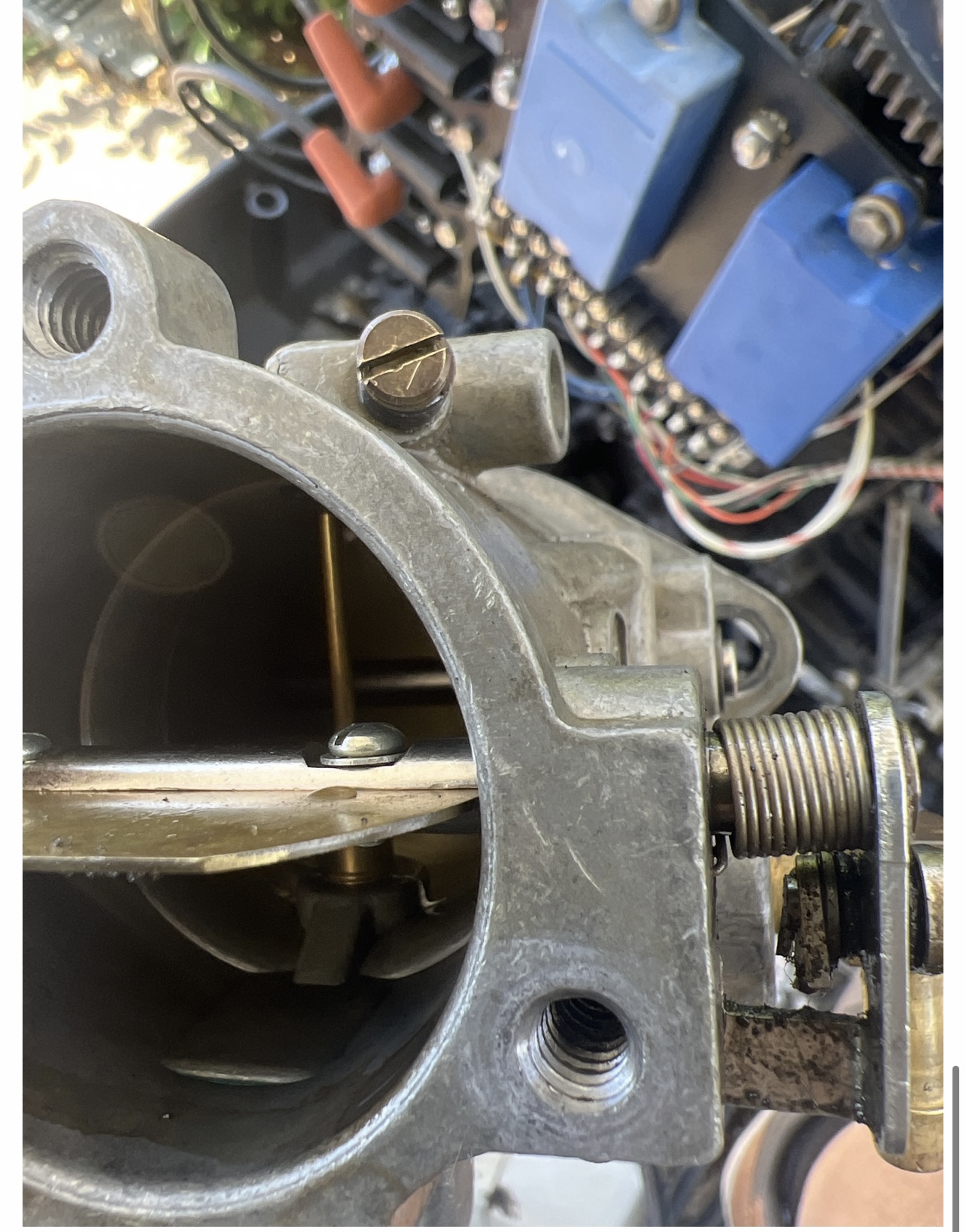

I have a 88’ force 125 that I don’t know how long hasn’t ran for I wasn’t getting sparked so I disconnected the magneto cable and now I have spark. I can get it to putt and run for about 2-5 second. Then it randomly turned on for about 12 seconds and then gave a loud pop like a backfire I think and shut off and put a lot of either soot or oil looks more like soot to me. Then I went to crank it again and it wouldn’t even putt. Seems like it wasn’t getting gas so I pulled the fuel pump didn’t take it apart since gasket was brittle blew through it which it was really had to blow thru still kinda is but better. And now it putt and turns on for a bit but then does the same think backfire and shut off. Also forgot to mention that I’d have a lot of gas dripping out of the carbs when I stop cranking the motor. I’ll post pics of old sparks

Seems to be at tdc to me couldn’t even put the screw driver in it. Does that mean I have to time it could the stator be installed wrong. Also the timing screw has been messed with the slot for the screw driver is messed up alittle
