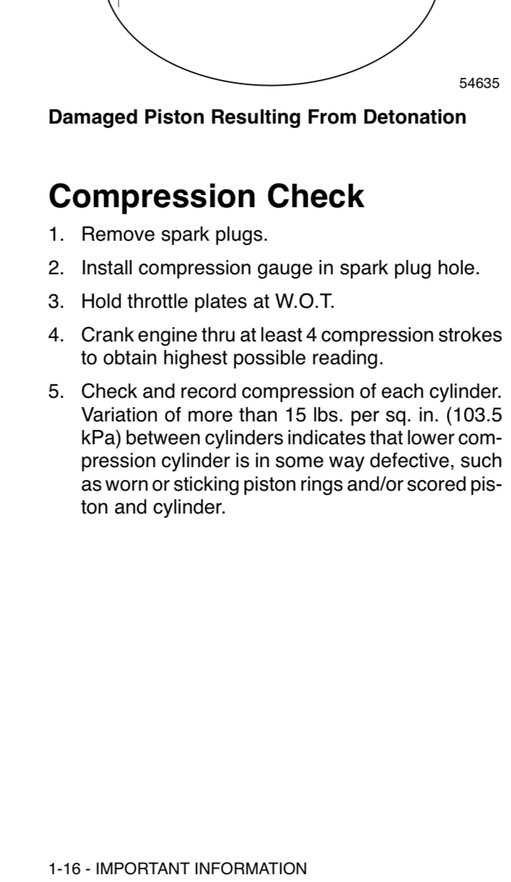

Let me walk what I said back a little. I know a 15psi difference is not what you want to see, but here's what the Merc service manual says, so it's for sure at the bottom end of being 'acceptable' (I use the term loosely) for a two-stroke this old. The motor runs great now, no overheating, no misfire or rough running, etc. Should there be anything arise in the future, I have added a deeper dive into the bottom cylinder to the list. Again, I appreciate your expertise racerone.

I just wanted to post a follow-up to this thread b/c I know that step can sometimes be forgotten. Long story short, I bit the bullet and bought a used carb body for my lower one and cleaned it really good. The motor has never run better! No misses, surging, or loss of rpm. I actually gained 4 mph in speed and my rpm also went up to within the acceptable range as it should be. I put a new prop on (11.8x10) and that helped my acceleration out of hole shot tremendously. I really appreciate all the help from everyone on here and sometimes I suppose we just have to go step by step until we get our issue resolved. Slow down...think it through...and use your gut. That helped me out tons. Can't wait to get it out on the water in the spring. Happy & safe boating everyone!
