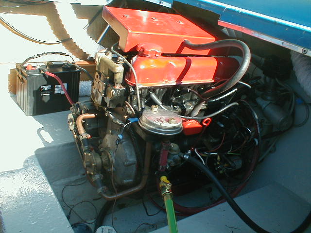

The attached image shows what I have done with my AQ130C. There was always a rubber block under the right side and I added the very dense piece of foam under the left side. Note the metal plate which supports both blocks over the bilge. These are not really mounts, rather just supports but they seem to work well.

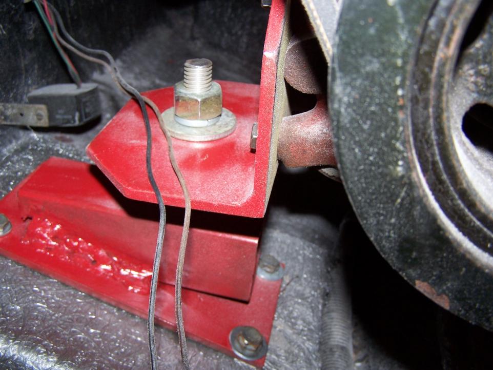

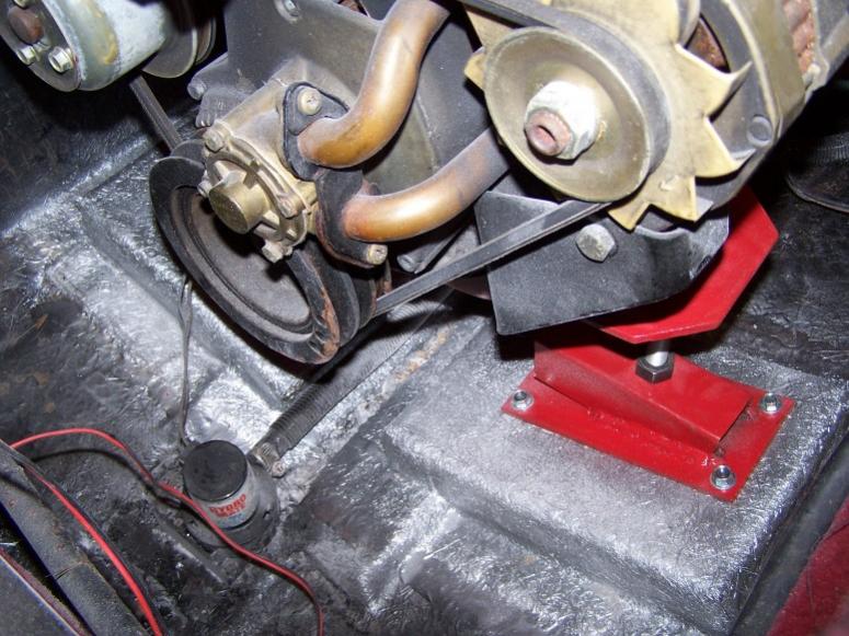

Here are some pictures of the mounts that a very crafty member in your very same situation made some time ago.
