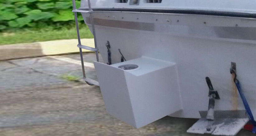

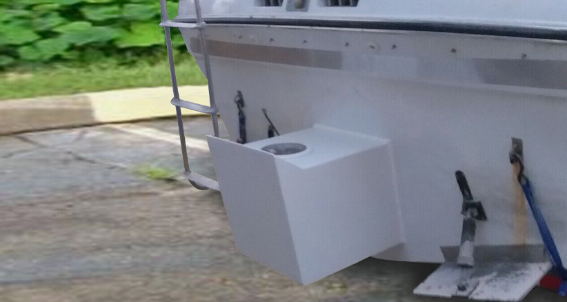

You can do a conversion to turn this boat into an outboard setup. They make brackets for the conversion that are not crazy expensive; however, you could potentially make your own if you have the skills and equipment. You just need to use aluminum and make sure to overbuild it and make it extra beefy. Although that said, if you buy one rather than fabricating it you will get the peace of mind that it was engineered/ built perfectly. Here is a picture of a conversion below.
As you can see it would cover the old transom hole as well.
They make different models that are more or less pricey depending on the size engine and style bracket you need. Just search for "outboard engine conversion bracket" on ebay and you will see dozens of options.
Are you using this for fishing or water sports like tubing? If this is for water sports you can get the model that has a swim deck on it as well. If this is going to be used for fishing you can get one that has an extra mount for a low horse power trolling/ emergency backup motor.
If you only plan to use this for fishing the outboard bracket would enable you to get a smaller more affordable outboard motor.
