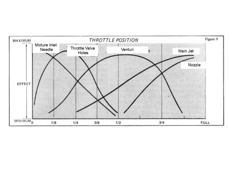

When you start looking a carb flow curve they look some think like this:
When you go to start you outboard or are trolling for fish, you are at the very bottom of the curve. The only thing that you have to control the quality of operation is the mixture needles. The only way I can think of to check the balance of the two carbs feeding three cylinders is temperature.
