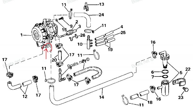

I got it running again. I took all of the VRO stuff out and installed the fuel pump from the spare motor. The VRO pump kinda fell apart. The very bottom where the pulse line ( I think ) hooks in separated from the main body of the pump. I had it idling well with the muffs. I will get another can and try it before I take it out. The pulse line from the VRO, I just plugged the hose and hose clamped it. I couldn't see how to get to that without taking the starter off. Pic attached to show where it separated. Thanks again for the help.
Update: Had the motor running and idling good. I realized that in order for the motor to idle I had to move the idle adjustments to extremes like before I did the carb rebuilds. I decided to take the carbs off and inspect them. Glad I did. There was all kinds of crap in the in the carbs jets and in the bottom of the bowl. It looks like the stuff from the VRO pump. After looking at the old VRO pump again, I realized the extent of damage to that pump. It was falling apart in tiny pieces and migrating through the fuel system. I ran the motor for quite awhile before I decided to redo the carbs and shut it down. Hopefully this will take care of my issues. Thanks again for all of the help.
