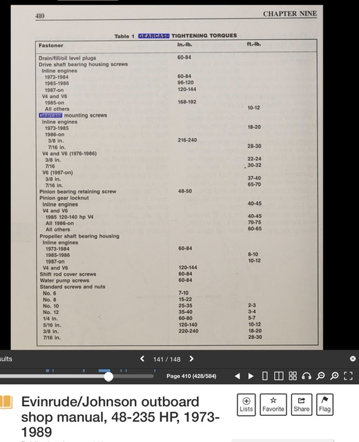

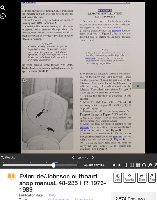

Can anyone share torque specs for a lower unit on a 1977 85hp Evinrude. Specifically the 6 lower hex bolts that secure lower unit.. Also, if you can share the torque specs on the water impeller housing bolts..
Thanks in advance
From the service manual
