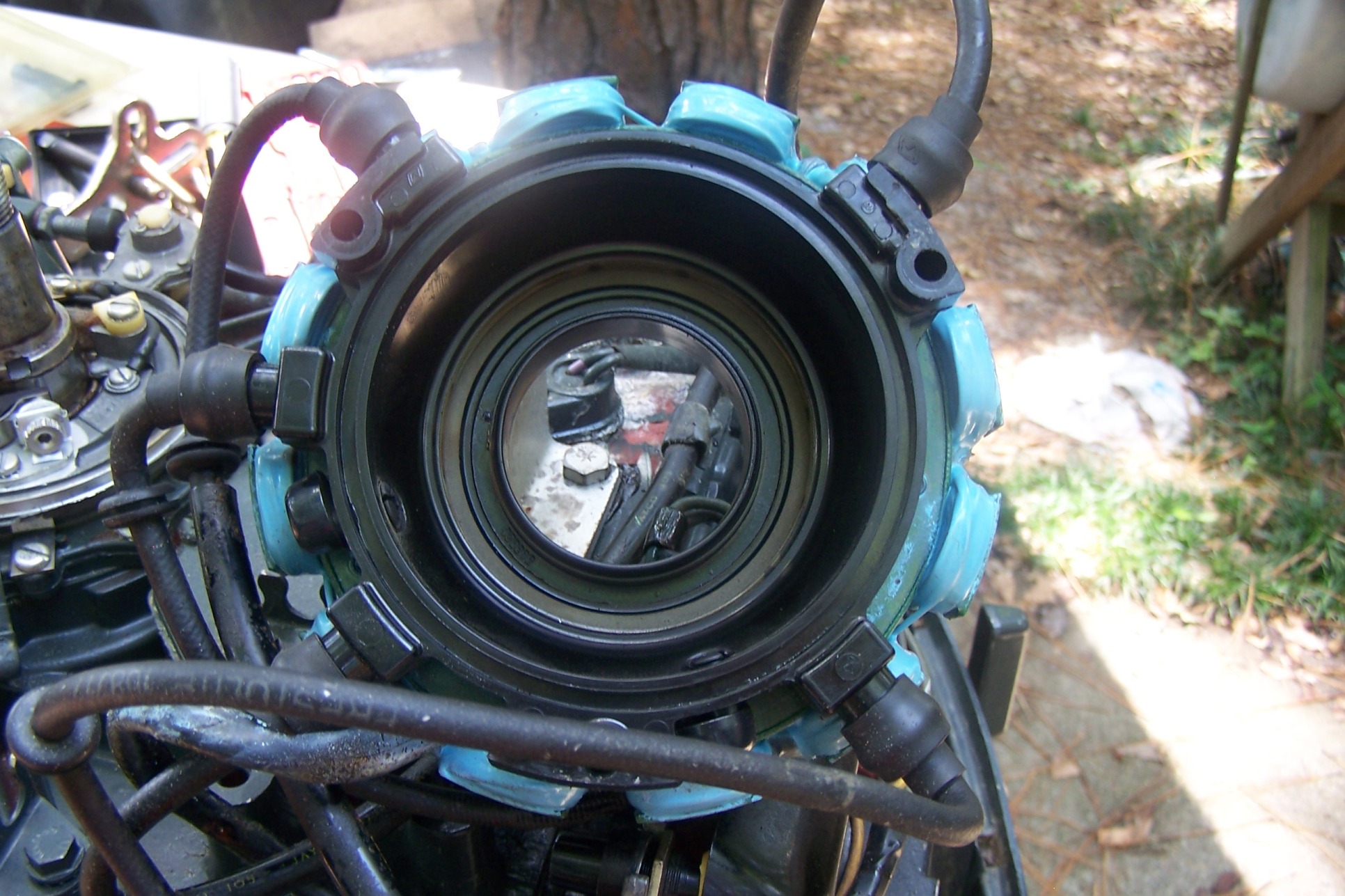

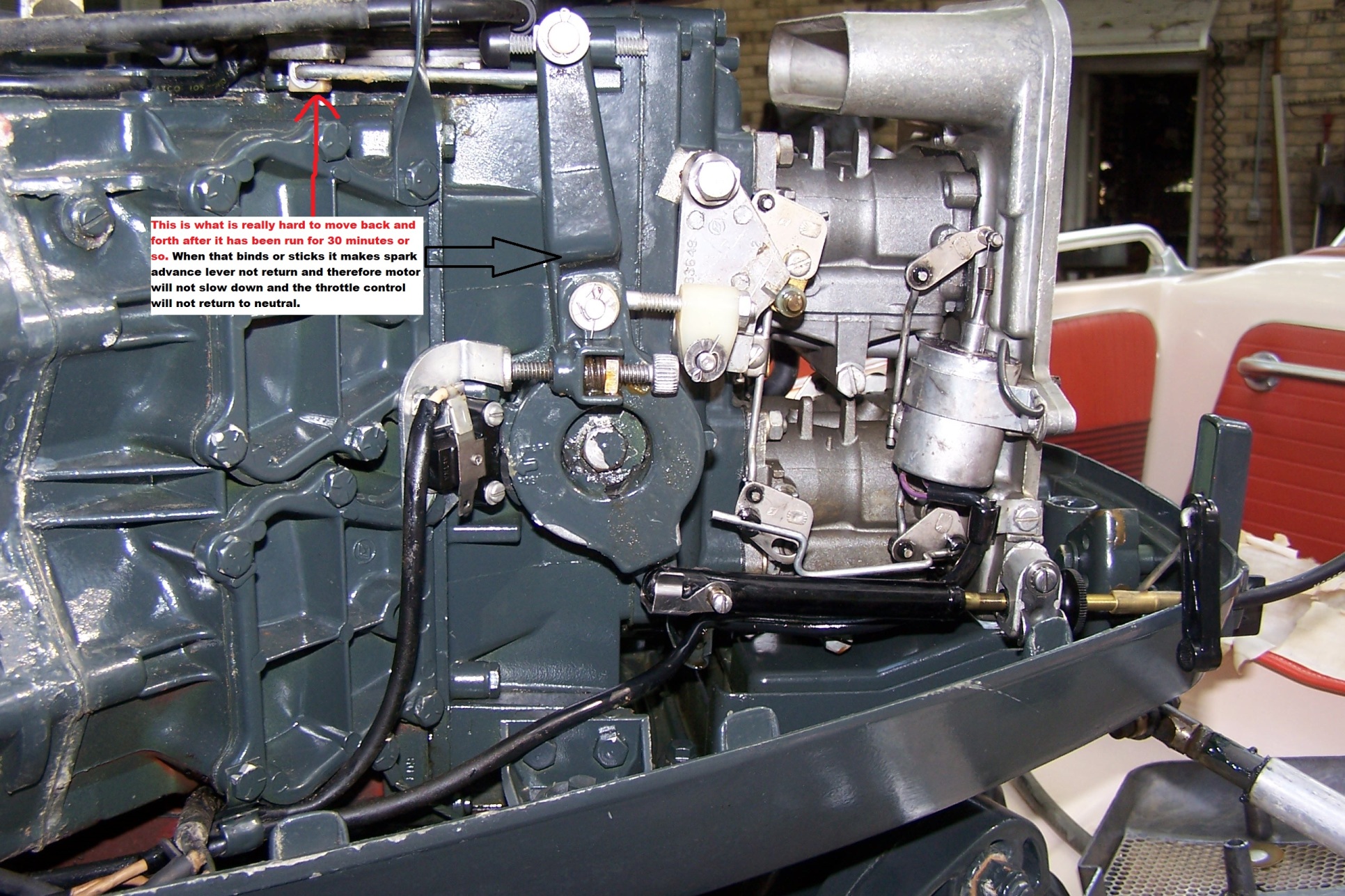

Hello to all. I have a 1969 Johnson 85 HP Model 85ESL69S and having a problem with the base plate assembly sticking or binding and making the throttle not return correctly. I have taken this all apart cleaned and re greased and at the time did not see anything I thought was wrong with any of the parts that would cause this binding issue. If I just work the throttle back and forth with it sitting in the driveway it works great and have even run it but was unable to get it to bind at that time. When taken to the water and run for a while it does it now every time. Anyone else experience this dilemma with this particular motor or another? Its almost as if something is getting hot and expanding causing it not to return as it should. When you push the advance lever back by hand to the idle return position it is very hard to push back by hand. Could it be binding on the distributor cap assembly maybe where it fits down over the base plate? Not so sure what else to do or replace at this time to help correct this issue. Once it sits in the garage overnight and you go back and work the throttle it works just as easy and moves the advance lever back and forth as it should.

Clean it well enough to eat off of, then don't use grease, only a drop of oil on the bushing and a bit on the retainer.
EDIT: Do I see grease in the groove? Don't do that.
Well I know it has been a little over a year but things happen and you know how it goes. Anyway a little update on this problem here. I have since taken it apart about 3 or so times now and I do still have the issue. I have since removed all the grease that I had previously put on it which did not help but did not make it any worse either. Once all that was cleaned off I put some oil on it like mentioned above and also as stated in the manual. Run it for about 30 minutes in the driveway and it started binding again so I decided to start talking it back apart right then I see if I could find the exact part that was binding me up. Moved the spark advance lever to the forward position and it stayed there as it usually does when it binds up. Pulled the flywheel off and started loosening the three screws slowly that hold the distributor down and when I did the lever returned to the idle position. I did go on ahead and remove it completely and the moved the base plate with everything else still intact and it moved just as easy and free as it could. So I then put the distributor back down on the motor and started tightening the three screws playing with the lever and if you get them tight and torqued like the book states it binds it up. I noticed snugging them up but not tight seem to help as the lever would still be free. Thinking I had done something I went put the boat in the water and run about 6 gallons through it and at first seem to be working but as time went on you know it binding up and maybe even worse than before as now it even has a time pulling the lever forward what less pushing it back. This lever should be spring return as I understand it from messing with it now so much. So what gives here new distributor or something else I am not seeing. Thought about shimming it up ever so slightly to see if that would help but I know you have the stator under the flywheel and not sure how many thousandths I could possibly shim it up before it hits or rubs. The groove in the bottom of the distributor and the part on the base plate that fits into it look perfect but something is amiss that is causing it to bind up. Something to seems to be moving or swelling up when the motor gets to a good warm working temp. When I pulled it out of the water I tried moving the advance lever by hand and it was very tight you really had to push on it hard to even move it at all and there was no returning to any position by itself as it was very tight through the whole range now. By the time I had gotten home grab a bite to eat and went back to take a look at it what do you know it was just as free as it could be. You could push it forward and it would return on its own. I seem to know now exactly where and what is binding it up but still unsure of the remedy. Any experts run into this on the older motors. I hate to just buy parts and throw at it when mine look like brand new but just not sure what else to try.
