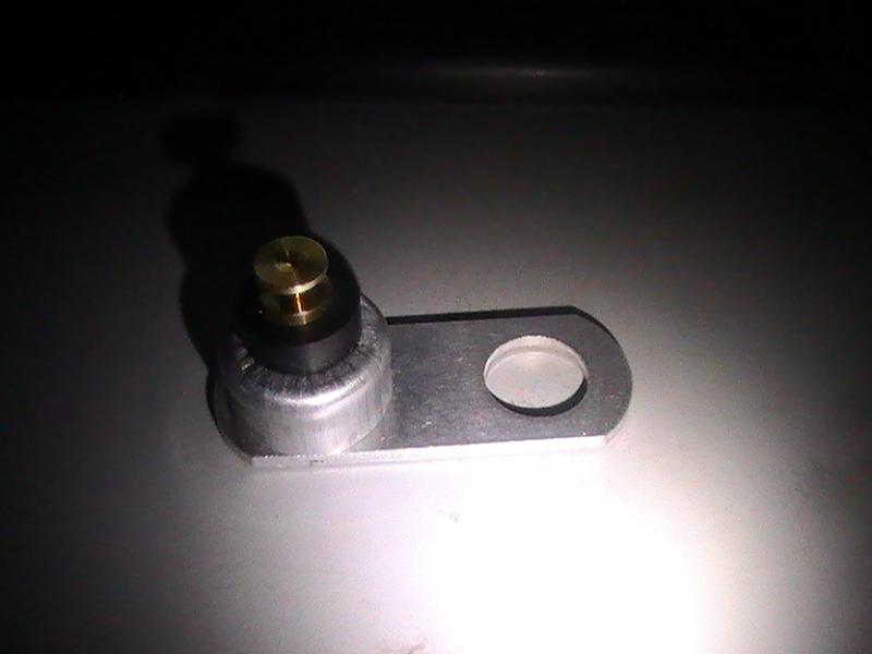

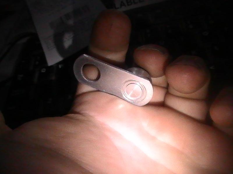

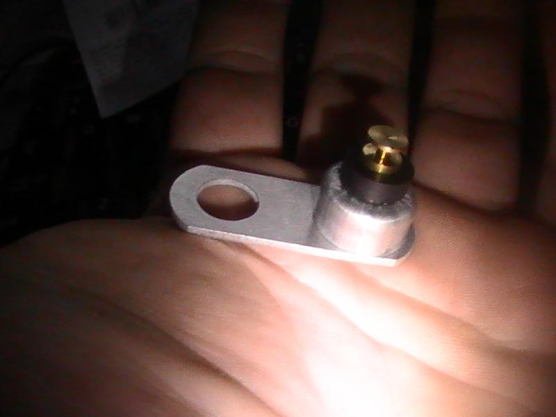

but if any of you have done this truck be great to share... its not the one that goes in the hole its the unit on a flat bar with the hole for the bolt and the other end is the sending unit itself
here is a pic of the sending unit i working with

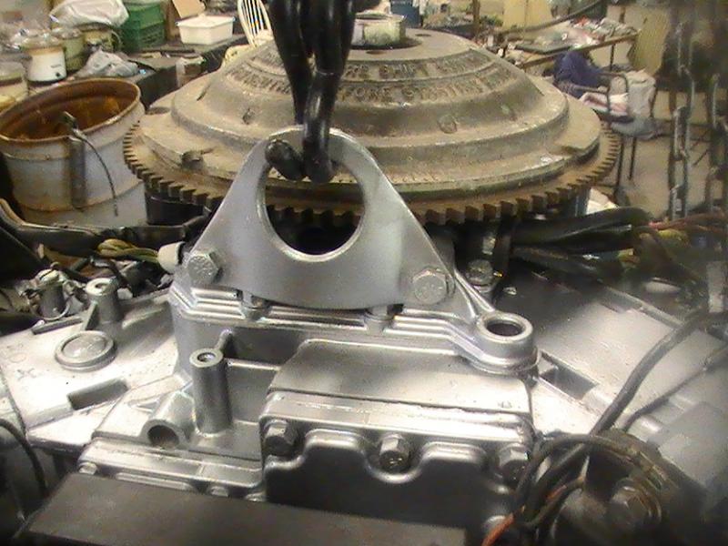

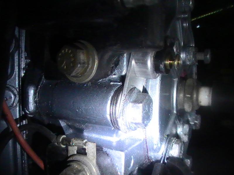

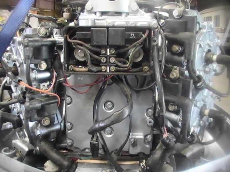

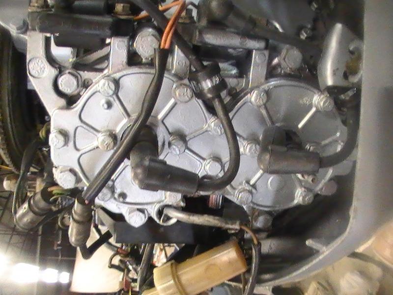

and here is the back of my engine there is 2 spots i guessing for temperature probs one by the top by the lifting hook
and the other is just behind the tilt trim box off to the side hole in the block but they both not threaded but of course it wont work for this sensor
not sure if faria makes one to push in there?

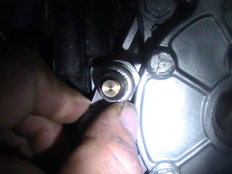

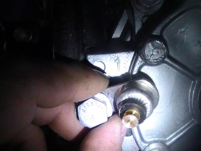

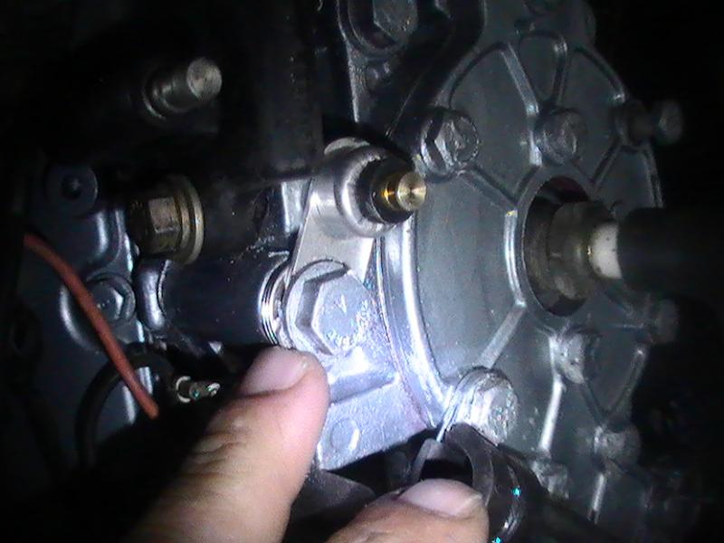

i was able to get a longer head bolt and added 3 washers to lift it is this a good spot to get a temperature reading???
here the pics

First I have heard of one like that. I would want to make sure the sender on the back was flat up tight to the metal and maybe put some heat sync grease to transfer the heat to the senser better? Let us know how well it is working.
ok i will i still gotta put this engine on my boat i rebuilt the engine so its going to be like 2 weeks i got baby robbins living off my boat right now so i havent bothered to do the install but once i do ill reply to this thread
ya i have computer thermal paste i can use..
and right now its pretty tight to the metal best i can do with what i working with but ill be sure to let you guys know
