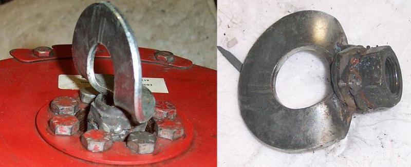

PS: Here's a neat (and cheap) way to make a power head lifter. Remove the crankshaft nut and buy a replacement from the hardward store, then weld (or get welded) a flat washer to it--see photo. Screw your lifter in place, ho0lka chain fall to it, and away you go.
