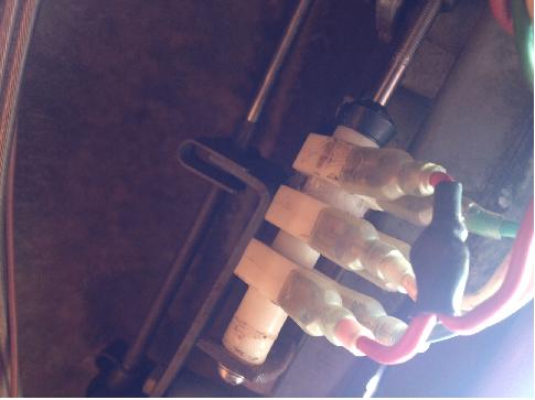

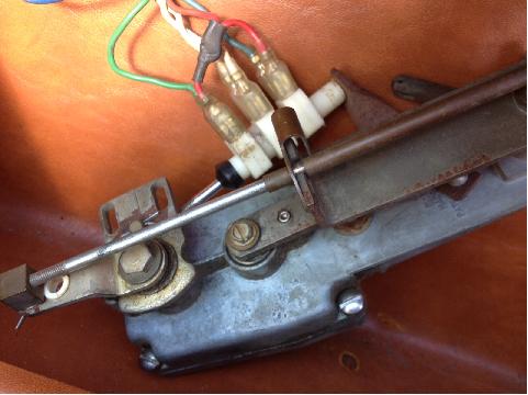

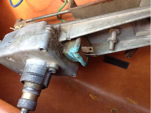

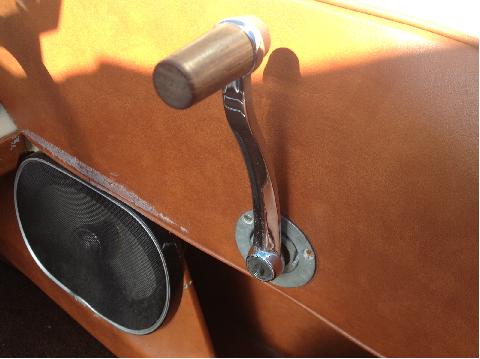

I'm hoping you can help with my 1977 Century 20' bowrider with 190 HP OMC 800 Stringer.
Put it in the water for the first this spring and the engine ran perfectly.
It would engage in forward but not reverse.
The revs would be controlled normally (ie: more reverse, more rpms as usual) just no engage into gear.
I attached some pics to help... maybe it will.
Please type slowly cause I'm no mechanic. I can tighten things, spot a loose wire, take stuff apart but only til I get scared I can't put it back together. That's usually pretty early on.

I do not believe that is an " 800 " model.----It is the old electric shift.----------Find the wires going into the drive at the engine.----Check ohms on green to ground and blue to ground.----If both are the same then apply 12 volts to blue and see if it shifts then.----------If it does not shift you may have a broken tab on the reverse spring.

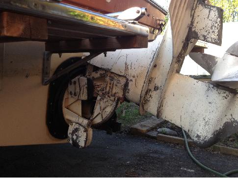

This is my outdrive. You say it is not an 800?
I was told by the marina it was. ??
OR Do you mean that the controls are not original?

That does not appear to be an " 800 " drive !!-----Just the old electric shift.-----The 800 drives were not electric shift and came out in 78 I believe.
OK. I took it back down to the water and and tried the electrical things as you said and nothing.

You are incorrect Bobbie. 800's were built at least as far back as 1969, I have one with electric shift.
You are correct that it is probably the reverse shift spring on the propellor shaft or the reverse coil. The forward and reverse coils are different the springs are the same. See exploded views on this web site and elsewhere. When ordering replacements, check the prop-shaft for wear and replace as well.
You may not want to hear this, but this is an old technology stern drive system.
You may want to consider cutting your losses now, and buy a boat with a different stern drive system.
1978 was the year OMC first introduced the "400" and "800" designations when the hydromechanical drives were brought to market. Like "Iron Duke", it's one of those terms people seem to like and so apply to everything similar.
1964-1977 drives were simply referred to as "The OMC Sterndrive"
Technically 400 and 800 series drives all have splined propshafts, but the terms have become somewhat synonymous with "stringer".
