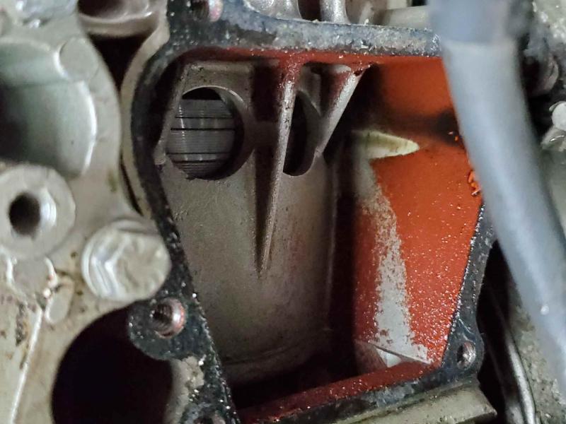

ok just did compression test 1,3,4 are at 95 psi 2 is at 100. I did a spark test 1,2,3 passed 4 would spark intermittently I am going to include some pictures of the spark plugs because they are only a week old and they are dirtier then ever and also some pictures of the engine in case you guys see something I do not like where the idle screw is pushed out too because of how I had to tighten the control linkage to get it running 20190823_132841_compress4.jpg20190823_132905_compress93.jpg20190823_132921_compress78.jpg20190823_132928_compress86.jpg20190823_125743_compress21.jpg20190823_132826_compress13.jpg
There are 2 wee covers on each side of the block.----Held in place by 6 screws each.----Remove them to look at pistons / rings.-----Compression numbers tell me that is your next move !!
