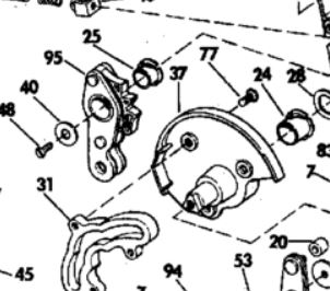

Hi I’m having a control box keeps locking up? If you don’t have the throttle and shifter cable hooked up to the engine the control box shifts perfect forward and reverse but as soon as your hook it up and go forward It will jump a notch And it’s locked and forward control moves back to neutral but still jammed in forward. I replaced the throttle cam put it all back together keeps doing the exact same thing just anyone have any idea? “I would appreciate any help” model #85693D S#J0001381
Parts # 37 and 95 are worn. Not exactly 100% sure, but I think that might be the year that Evinrude replaced all the controls under warranty. You may or may not have the latest version. Be careful you get the correct parts.
EDT: 44 years can affect memory, but I believe #95 was 778207 and replaced by 0386542

yes that makes sense to me. Every time I take it apart the ball bearing is in the wrong slot. So I would have to move it over one space for it to line up with the neutral switch. Ok I will replace that and see. Thank you very much for your time! I realize it’s not 100% I would rather replace a couple of parts and keep the original control box. This morning I’m going to take it apart put it back together and try shifting it with the motor running and see If it’s landing in the same spot.

Hi I went ahead and replace those 3 parts starting with t Throttle cam and #37 and # 39 and it seems to be working thanks , also I’m going to take your Advice and not shifted when I’m not in the water.
