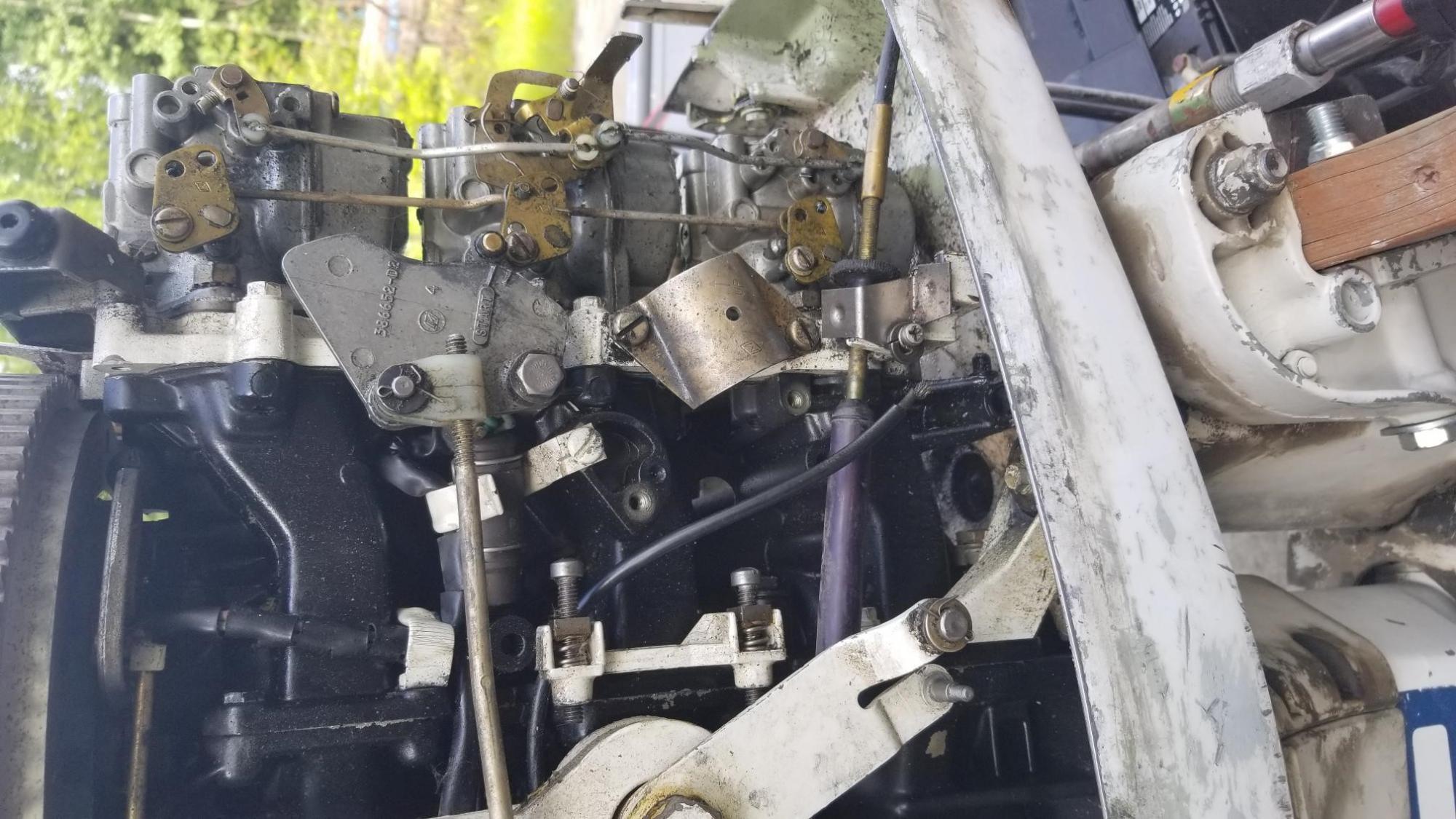

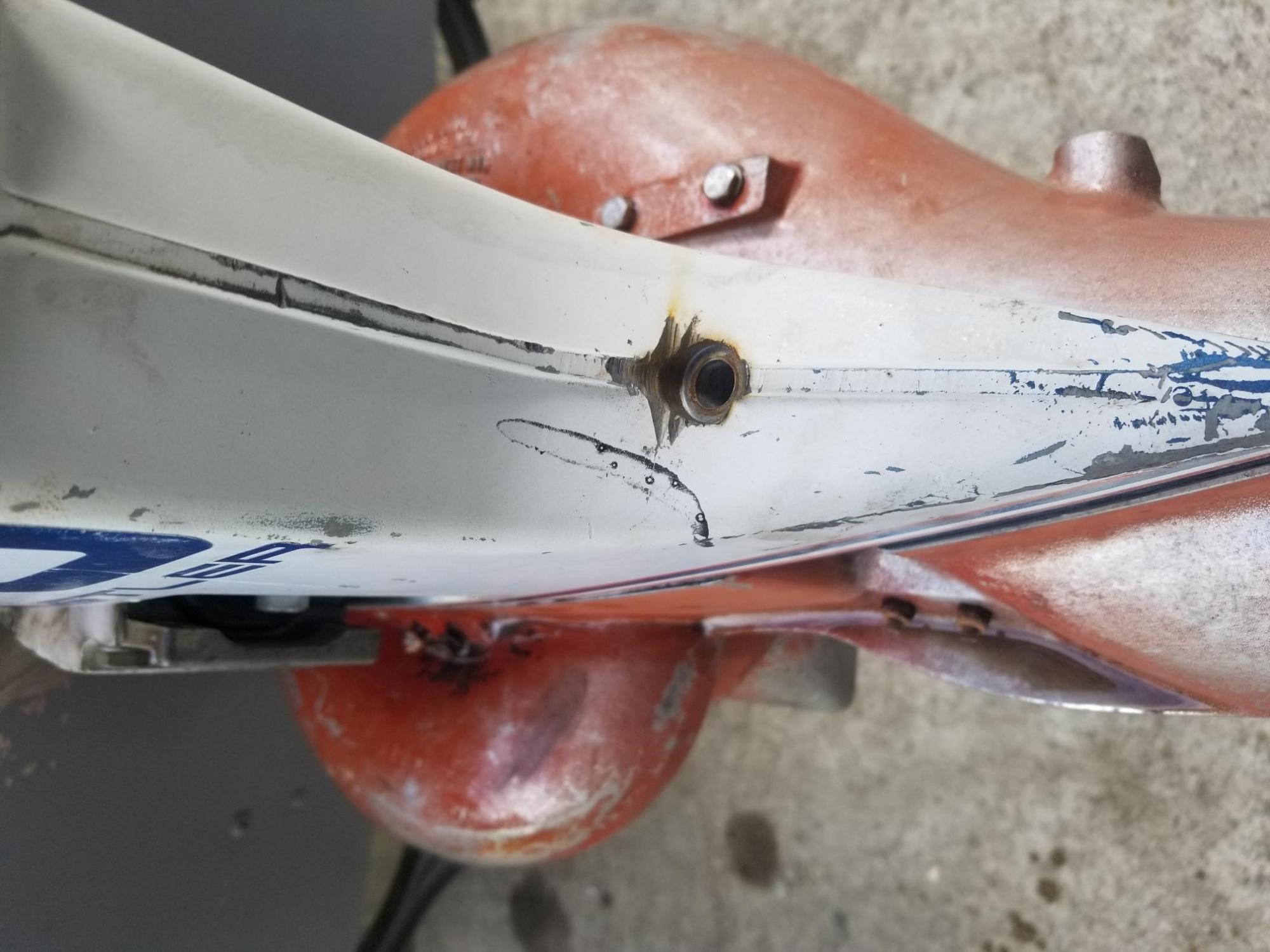

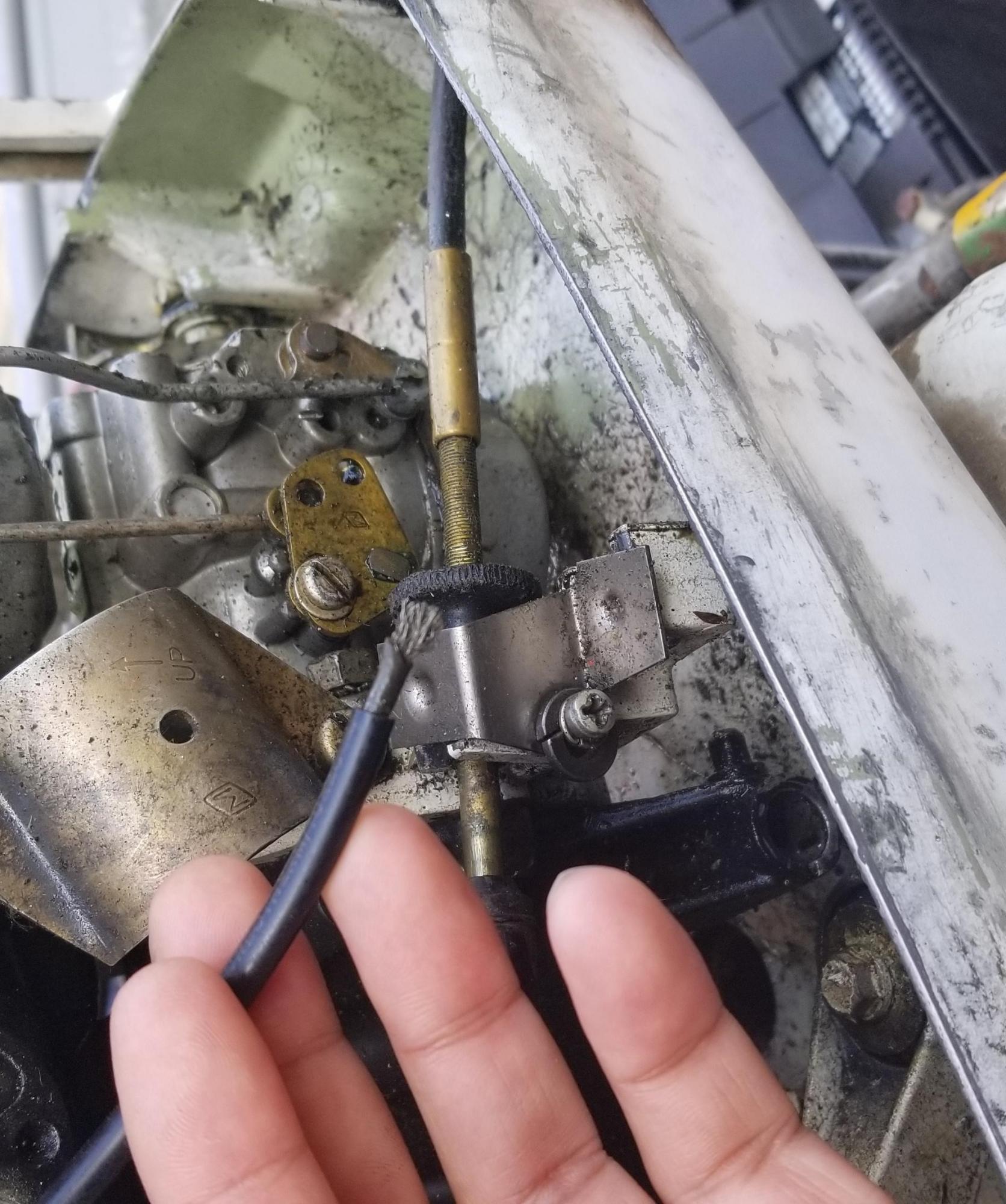

Well I guess having the choke solenoid missing from the motor would explain the electric choke not working...Figuring things out slowly but steadily
No -----The standard Evinrude control has always been forward for forward !!------But here is skinny.-----The 73 and 74 model lower units shifted opposite to newer motors.-----The 74 model outboard shifted to forward with a DOWN motion of the shift rod.------Later models shifted to FORWARD with an up motion of the shift rod.----This was done with LINKAGES on the motor.-----Nothing to do with the control box.
Thanks for the explanation. So just to be clear on my 74 model me pulling backwards on the throttle in order to go forward is normal for this model year?
Hi welcome to the forum.......NO, somebody switched lower units......put something 1975 or newer.....this happens quite often, either have to get the correct lower unit, or come up with the linkage to reverse the motion up above at the end of your shift cable. These kits may be available....try Tim's Outboard in Hackensack MN.... Mike, Dan, or Teresa....218 682 2331.
Oh ok. Yeah the lower unit was swapped over with a jet drive so it looks like they put the wrong one on there. I'll have to take it over to the local boat shop and see what the options are. Luckily virtually everyone here runs jet drives from the same company so I'm sure the shop has seen this problem before.
