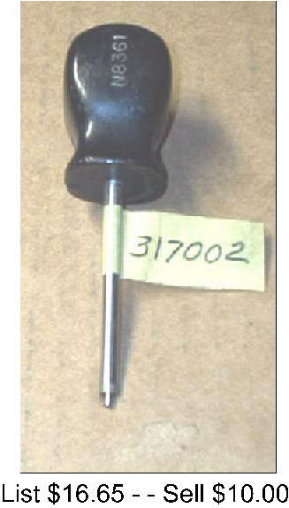

There is one brass high speed jet located behind each of the drain screw plugs of the carburetors (4 in all), and the slightest restriction of any of them will result in what you're describing. Clean them carefully with a piece of single strand steel wire. They have 14x20 threads and can be removed via a screwdriver that has a shank that just clears the drain screw plug threads (also 1/4x20) with the regular tip cut off, then the shank filed to resemble what you see below. Or order one from this site if they stock it, or at your local dealership
Trying to use a regular screwdriver tip will usually result in jet orifice damage... As Joe Namath states in his commercials "I guarantee it!" (Ignore the price mention, Long Gone)
View attachment 21469 <-- Ignore the price mention (Long Gone)/
