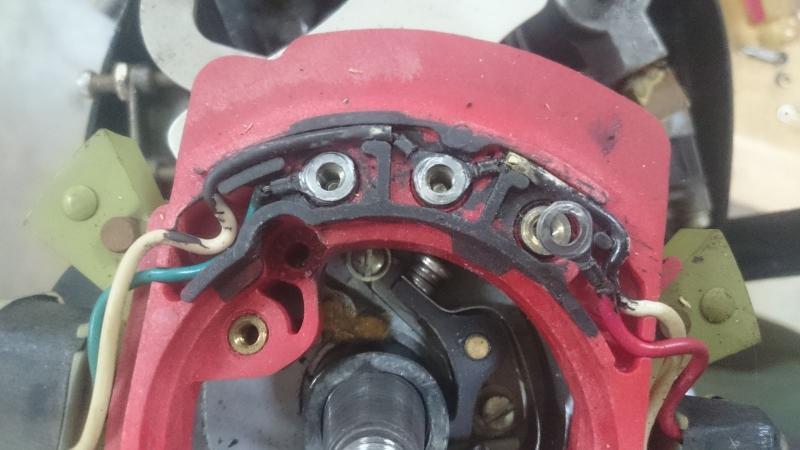

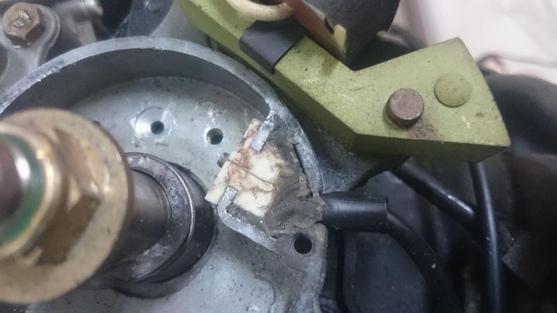

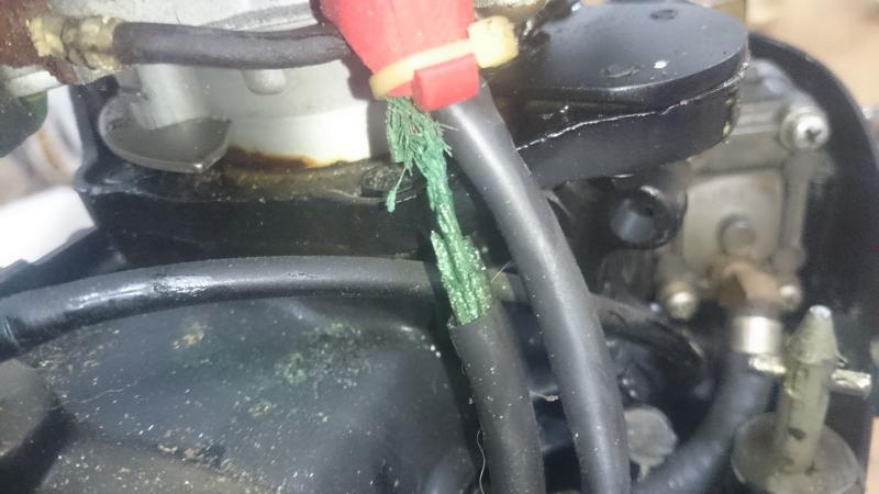

Hi there - bought a gr8 freshwater merc 40 single last week. Rewired the head/coil wires (they were blistered). set points gap at 0.020 (it was closed!)..
