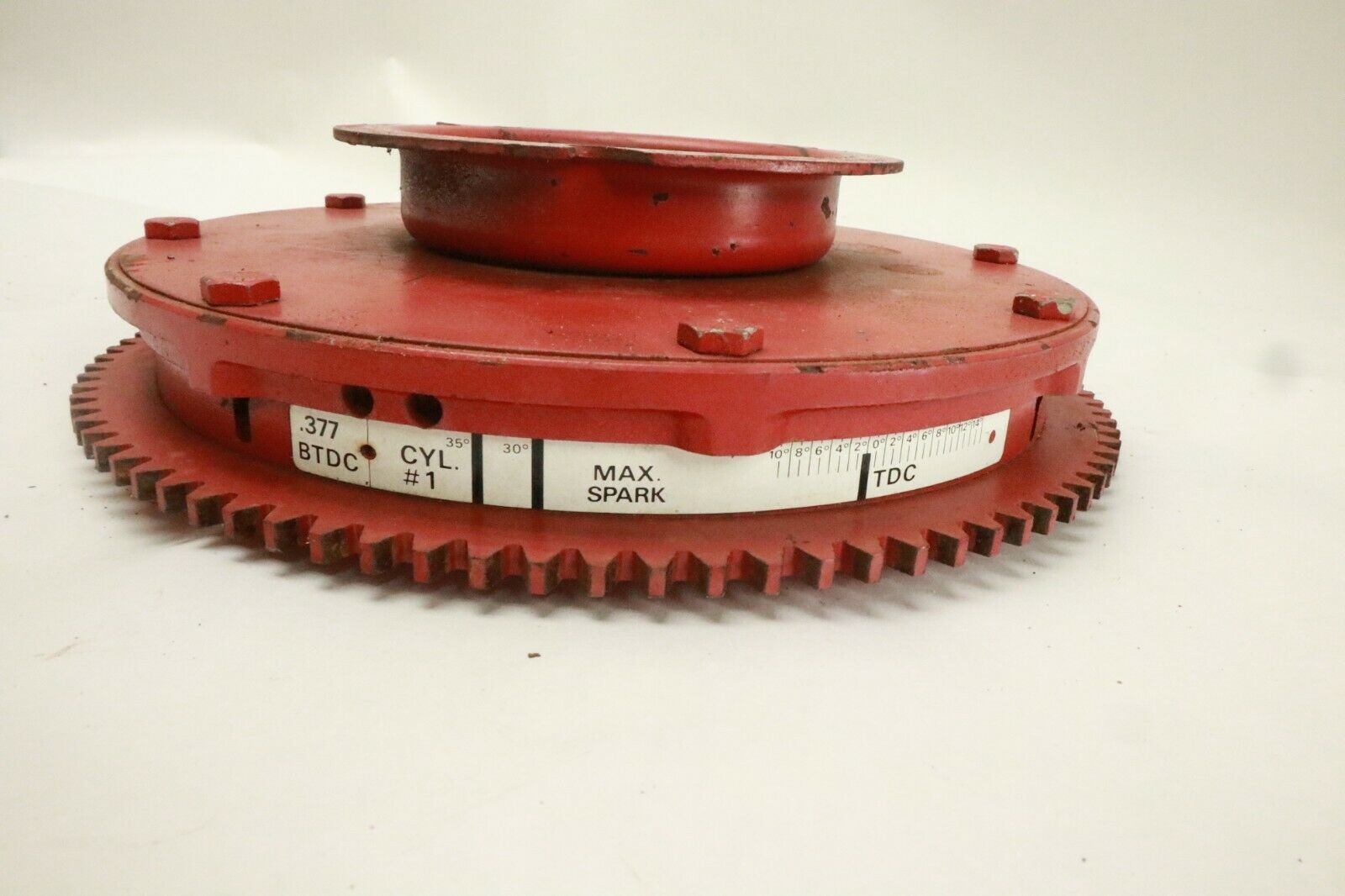

I have the link & sync procedures ready to go for a 77 Merc 50 HP and all seems pretty straightforward except step 2...
Summary:
1. Set pickup timing 7-9 degrees BTDC which allows carbs open at right time
2. Set max spark advance 32 degrees BTDC
3. Return to idle (forward gear) adjust mixture screws on carbs for best idle (then richen slightly)
4. Final step, adjust idle speed with idle stop screw to achieve idle of 600-700 rpm in forward gear
So, would it be a huge mistake to skip max spark advance? I have seen videos of people setting this on open water and it seems pretty wild. What's the best/safest way to do this? Would you assume this is set correctly and skip it?
