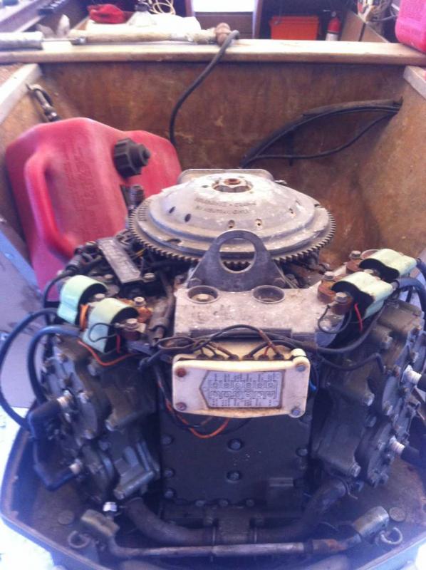

Newbie here... long story short... I have not had this engine in service for 10 years. I am now retired and have some time, and I want to get this running again. I have fogged the cylinders and I have turned over the engine a couple of times in the past ten years. Today I drained and refilled the lower unit and I think that all went well. About a 1/4 water cup clear water came out, then clear looking lube. I then refillled it. Sometime in the past I plugged the plug wires, and thought I would know by the length which wire went where. WELL, that is what I get for thinking like that. I have a Clymer shop manual, but cannot find anywhere that tells me which coil goes to which cylinder.
I bought this engine 20 years ago, it is a V4, 115 HP and I think a late 70's model.
I have several pics... I hope these help someone tell me if I have the plug wires hooked up correctly...
thanks for any help...

marked on the outside of the CDI package the org coil wires are numbered.
I followed the org wires and found the following
Looking at the engine from the back, the coils are 2,4 and 1,3 left to right
Now how do I ID which cylinder is 1,2,3,4?

OK... after more reading, I'm thinking the cylinders on the V4 are: left top is 1 bottom is 3, right top is 2 and bottom is 4. So it appears (in my previous picture posts) I have the left cylinders hooked backwards, but the right appears correct... and it was the left ones that I was most unsure about.

Sorry ---Cylinders are numbered from top to bottom.--The top cylinder on the motor is #1 and the bottom cylinder is #4.-------Work slowly and carefully or you will make expensive mistakes !!!------So I doubt that the wiring at present is " wrong "
this is the V-4 engine, not an inline 4
I thought I saw in another post where a V-6 engine was 1,3,5 on one side and 2,4,6 on the other... from that I took that the V-4 would be the same... 1,3 and 2,4... am I wrong? The orange coil wires (according to the description numbers on the CDI panel) run to #1 and 3 coils which are located on the left and #2 and 4 which are located on the right...
the cylinders have to be 1,3 left and 2,4 right ...
I can't see how the cylinders would be 1,2 left and 3,4 right... I never disconnected the orange coil wires... only the spark plug wires.
Am I missing something, racerone???

Sorry mate !!!-----I have 40 years of experience and know what motor you have !-------There is one cylinder at the top ( starboard )and it is #1 the one below it is # 2 on the port side then #3 on the starboard side and then the bottom #4 on the port side.--- Look carefully and work slowly to avoid costly mistakes !
Thanks for the advise. In the bright sunlight I saw cylinder numbers stamped on the engine. Your description above was correct, and I did have one lead incorrect. Gotta put this puppy in the water to see if the engine will run.
