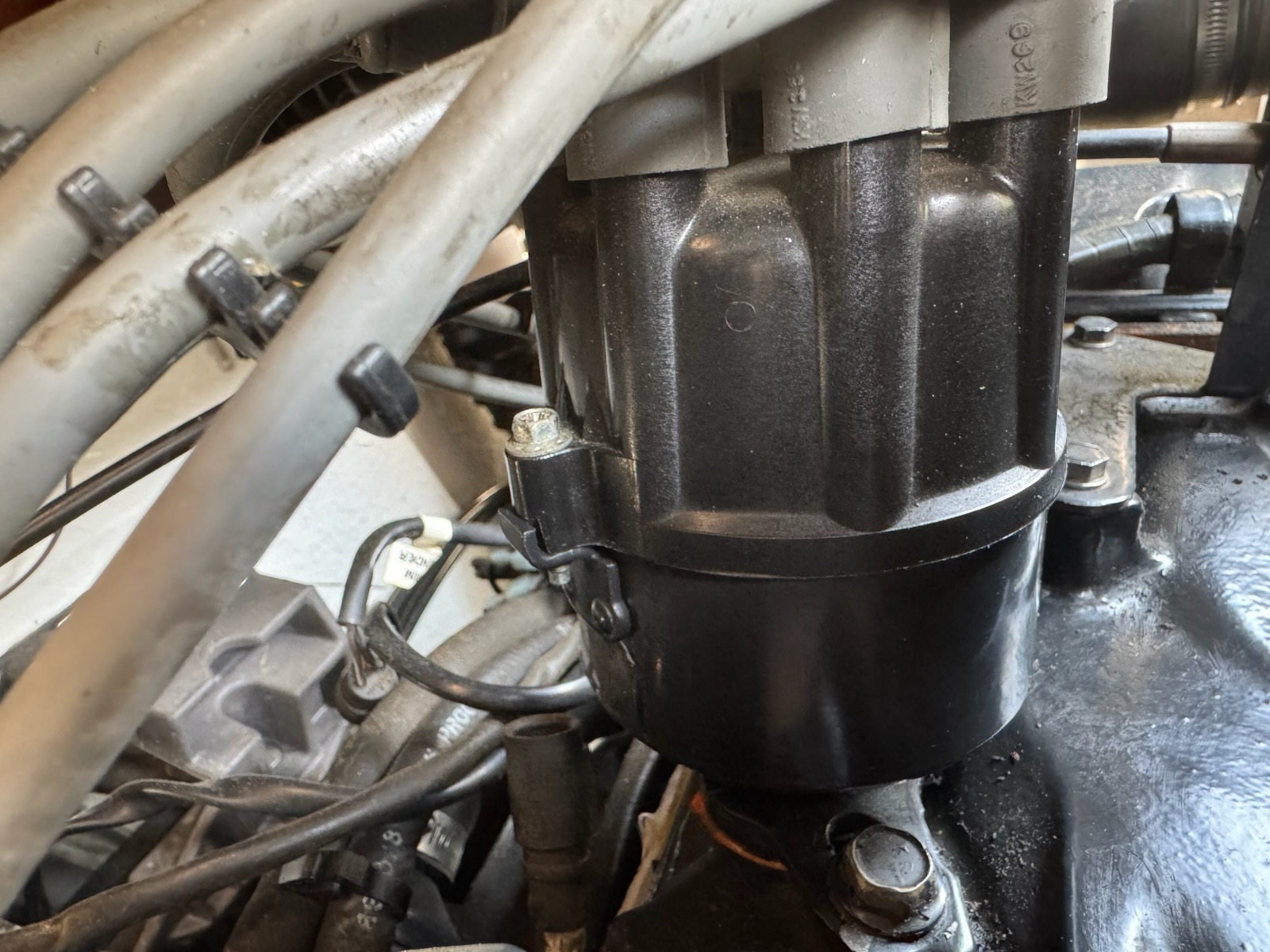

Ok fellas I just got home and got me some food in my stomach, I got 2 pictures best I could get of the distributor unless I take some interior parts out. If I need to that’s fine I was just going to see if these would suffice. And as far as the timing goes unfortunately I am a shop foreman at a Kubota dealership and all of my tools are at work so I will have to see if the timing changes with higher rpm tomorrow after work. Please any info on type of ignition system this is would be awesome or what would be absolutely killer is a link to a workshop manual for this engine! I’m a diesel mechanic so this type of timing is new to me lol

What you have is the Prestolite distributor, so its point a shoot
Pics
