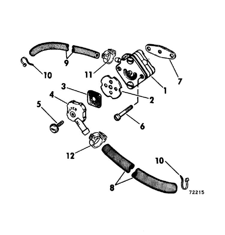

I'm fixing a 1968 6hp CD-25A for a friend and when I looked at the fuel pump, it has a home made gasket with an opening the same shape as the fuel pump intake hole, a smile shape. That gasket opening is much larger that the OEM gasket, which only has a small hole, see part #2 in diagram. Should I just leave it as is, or make another gasket with one hole (only one of the four holes aligns with the pump intake "smile").
Shape of the hole makes no difference. Only thing that matters is that the fuel gets through it and into the pump.
