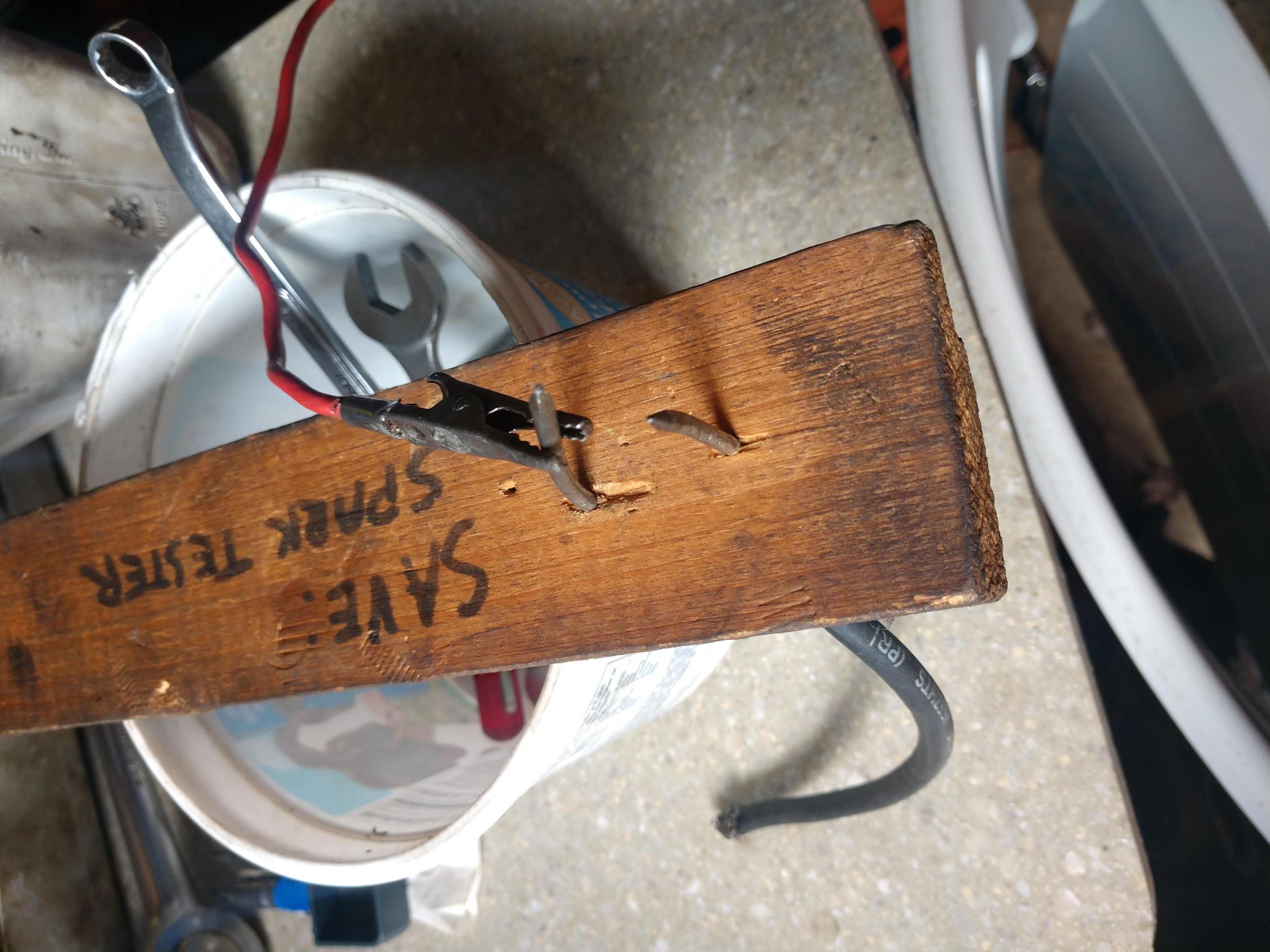

Right, Racer. Can you see this key from the top, so no need to remove flywheel if it's okay? Note: 1/4" spark is insufficient. Rig yourself up a simple spark tester. I can show you what I have here.....now don't get jealous. IMG_20200413_123938033_compress69.jpg
And besides there is a patent pending on this one.
I had to mark on it because I found it in the kindling pile once.
