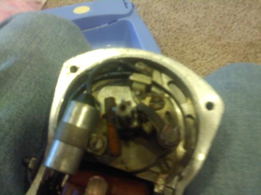

i got all that off broke the rotor but dont know what the points are all under is the rod with the little strips around it rubbing against it

The shaft that rotates has a 4 lobed cam on it ----------The points are opened by this cam as the shaft rotates.------------Over time the block that rubs on the cam lobes wears and the points no longer open the required amount.--------------Set points with feeler guages.---------Points must be absolutely clean !
Like I said go to those websites and see what " points " look like.-----------Lots of pictures posted for you to learn about this old reliable stuff.----Points are also called " breakers or breaker sets " for those who want to learn.
Sorry , but the point gap is not set on the cam or the rubbing block.----------------The wee round contacts half way between the rubbing block and the pivot point of the moving arm is where you set the point gap.-------------Work carefully before you make expensive mistakes !!-----Perhaps there is a tutorial on U-tube for you to become more familiar with this type of work.---Search for it.
downsized_0423121809.jpgyou cant see it very good but i dont see any round anything in between the rubbing block and contact point or know how to adjust it
Set the points at 0.010 inch open at the top of the cam, then spin test the mag with a drill. If you see a bright blue spark 1/2 " long, reassemble everything and go boating. If not...get back to us.

does the real manual have better pictures of the points? i baught a downloadable one and doesnt have anything but some crappy diagrams and parts lists

i set the the points and i can see the spark but its not that big of a spark and had to be in a dark corner and get the drill spinning it pretty good is that normal or could there be something else wrong? it will spark enough to shock you just by turning it but cant see the sparks unless the drill is spinning it pretty good could that be whats going on why could only get the boat to start and run at almost full throttle?
Spark should easily jump a gap of 5/16" or better ----A small electrical storm so to speak.----------------If it does not then magneto components need more testing.
