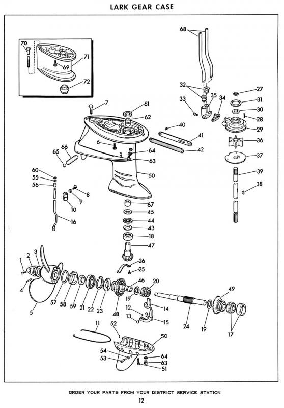

Put the hammers and wedges away !-----------Is there a rear cowling hiding it !------Have you looked at a parts diagram for your model ?
Item # 7 in lower unit group and listed as item 12 in swivel bracket group.-----------Find it and remove it !!!!----Get a 9/16" wrench ready.
Simple. You have to remove the rear cover that covers the midsection (whole bunch of screws). Ah-hah!!! There is the bolt.
#7 (Short Shaft) or #70 (Long Shaft). You can't see it till you get the rear cover off.
